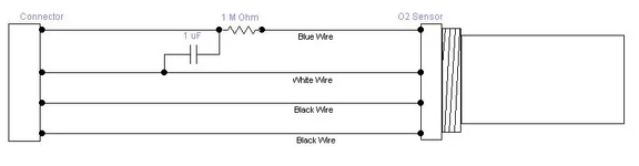

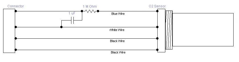

I was wondering if the MIL/CEL fix would work in conjunction with the FP 02 clamp? anyone?
It's worked for me...I have the Cel Fix in..Hmm...Maybe that's causing my Problem w/ my stalling issue??
Chas
someone asked keith@FP, and he didnt know what the check engine light fix was. I dont know of anyone else running the two in combination. I dont see why it would cause any problems, but you never know? I would ask him.
I have just attached a copy of the fix i used!
Chas
That's for the CEL..It basically gives the pcm a signal that all is ok..
Not sure if it's affecting my setup..but i might just uninstall..and see if it makes a difference!
Chas
Yes..I do have that voltage clamp....
The cel fix i installed..is ususally used when you remove your cats..
Chas
NOpe..No CEL at all! Unless my car stalls..than all lights come on!
Chas
