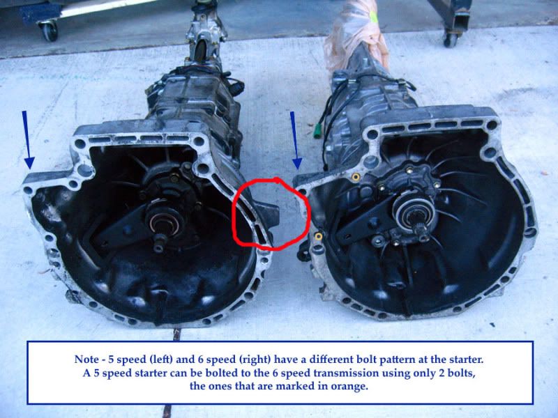

If only one bolt was in the starter the whole time, it was probably like that before the swap too. I have a feeling that there was a lot of mystery work done to the car before I bought it. Two of the bolt holes are invisible to the naked eye, and one of them is borderline impossible to get both your hand and a bolt in there at the same time. This, of course, is the one that I used for the 2nd bolt. haha.
Well, after some research done by Amaff, it turns out that the 5 speed gearbox and 6 speed gearbox bellhousings have different mounting points for the starter. This means that the 5 speed cars and 6 speed cars have transmission specific starters. But... you can mix and match, you just can't use all 3 mounting points.

Would have been nice to know sooner, but... at least it still works.
And the circled aluminum tab needed to be cut off to fit into your car.
