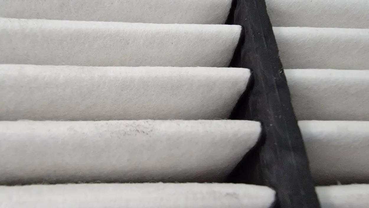

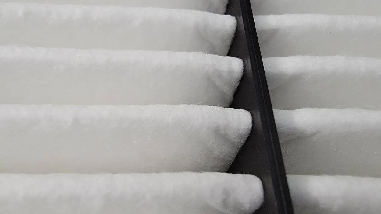

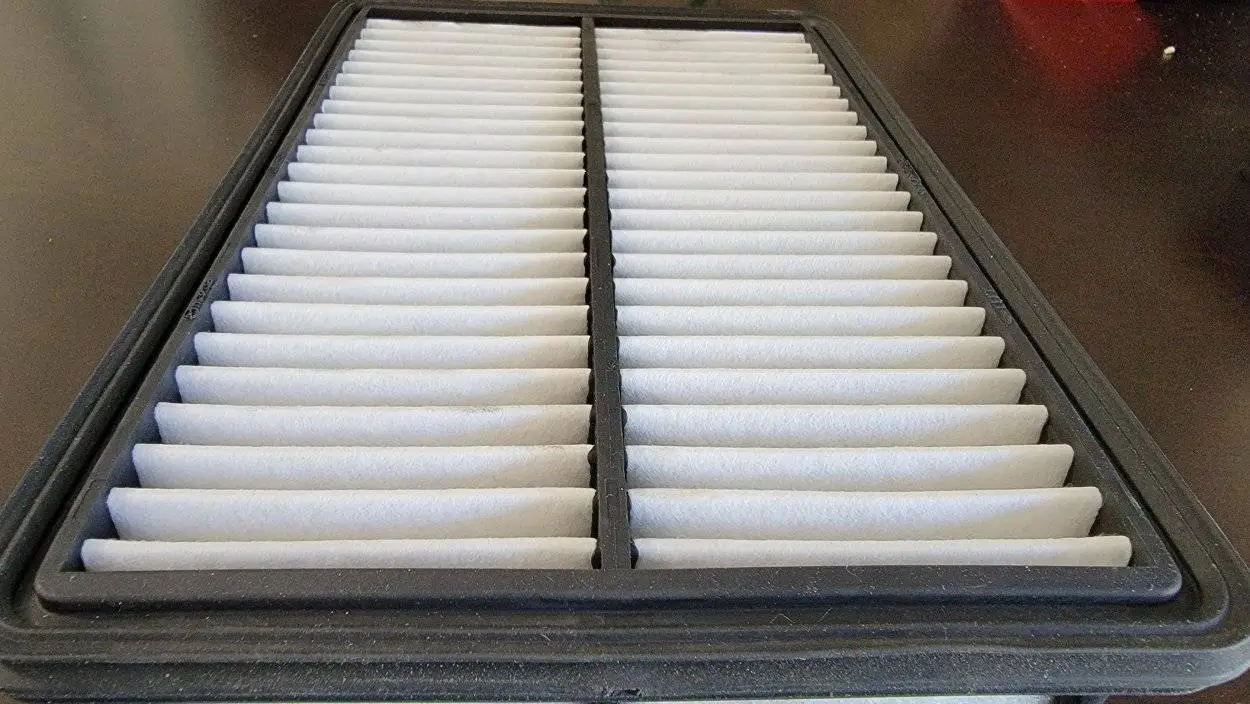

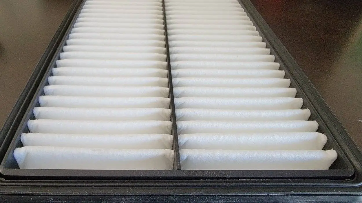

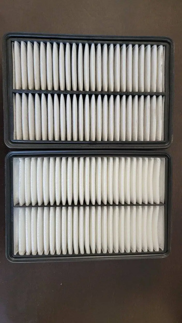

Can you elaborate a bit on the difference between “Value Products” and real genuine parts on engine air filter? More filtering area (more folds)? Thicker paper element?
There is a substantial difference in the build quality. The frame on the factory OEM is made of a heavier rubberized material with a thicker rib down the middle. The MV is much lighter and is made of a hard plastic.
There is a difference in the filter media, which I will not go into right now. I ordered a new factory OEM filter so it will be easier to do an apples to apples comparison. Would not be fair to compare a new filter to a used one.
Your old filter looks very clean. Did you blow all the junk out of it? I see what you mean about the housing vs the MV.
