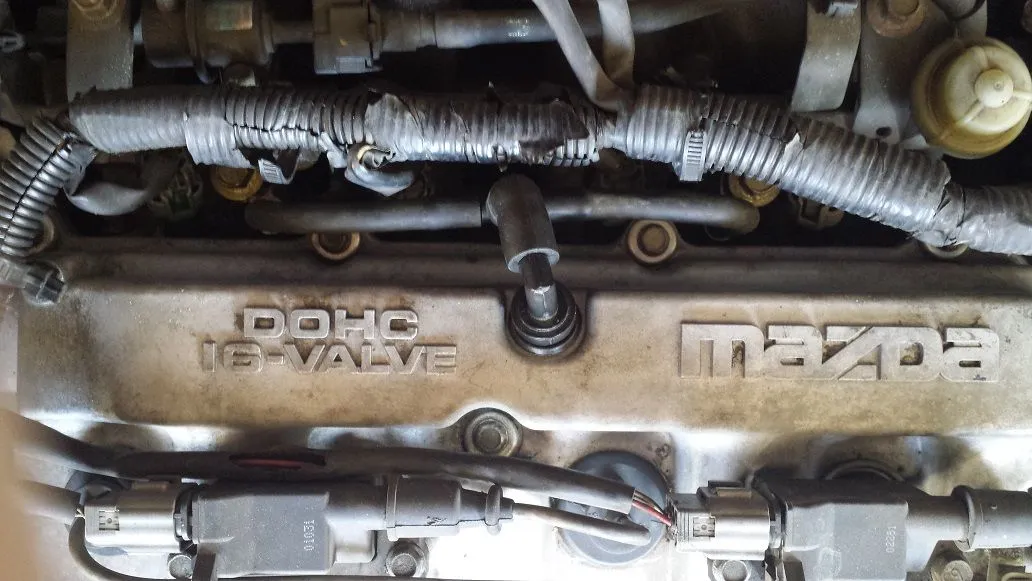

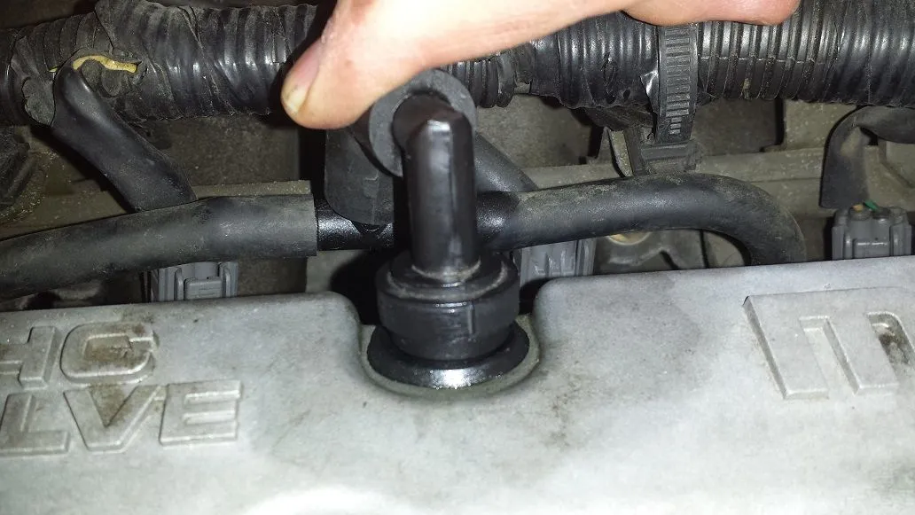

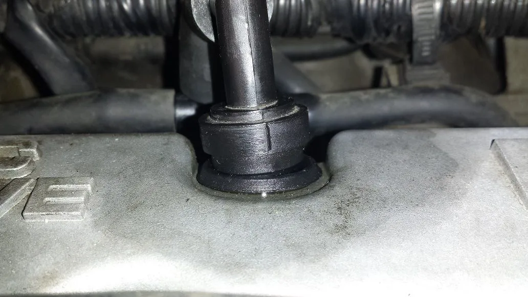

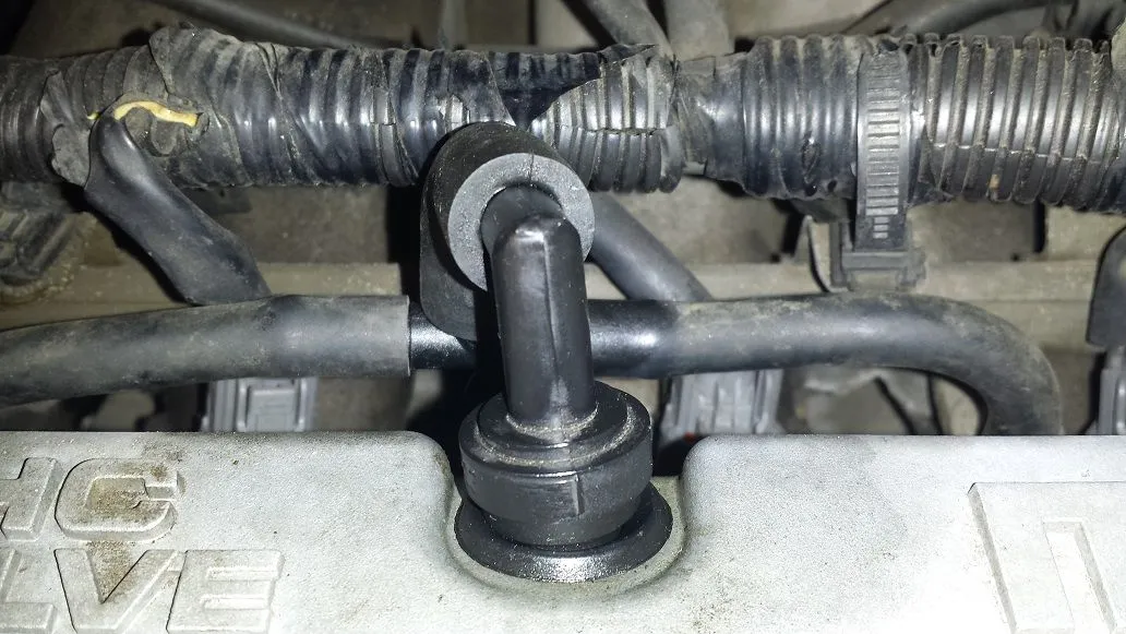

Here you go. There are two side views and one top view showing the angle at which it sits. There is also one side view where I pulled it right with my finger, to show how much it rocks.
The PCV valve is marked "2223" and "USA", so presumably it isn't OEM. The grommet is soft. I think these must have been replaced after my daughter overheated the car, even though I don't have any paperwork saying that work was done. The PCV valve rattles when it shakes like it should work, but just turning it over is enough for the valve to open. Is that normal for these cars? It seems like this one either doesn't have a spring or that spring is very feeble.

By the way, I retaped that nasty looking wiring harness this afternoon with this stuff:
http://www.dormanproducts.com/itemdetail.aspx?ProductID=35197&SEName=85291
It was the only thing the PepBoys had that didn't look like it would ooze adhesive all over the place. All of the thin outer tape from the factory was cracked and falling off. There are 5 zip tie thingies holding it in place and the 3 which run along parallel to the valve cover were broken. The hooks were still good, but the strap parts had broken. Two of these can be seen in the top view picture in the previous post. PepBoys didn't have anything like that, so for now I cut off the strap part and ran some regular zip ties through the strap space in the resulting stub to hold the wiring harness. Hopefully the zip ties I had on hand won't melt in the engine compartment. Anybody know where to get these things other than the stealership?
