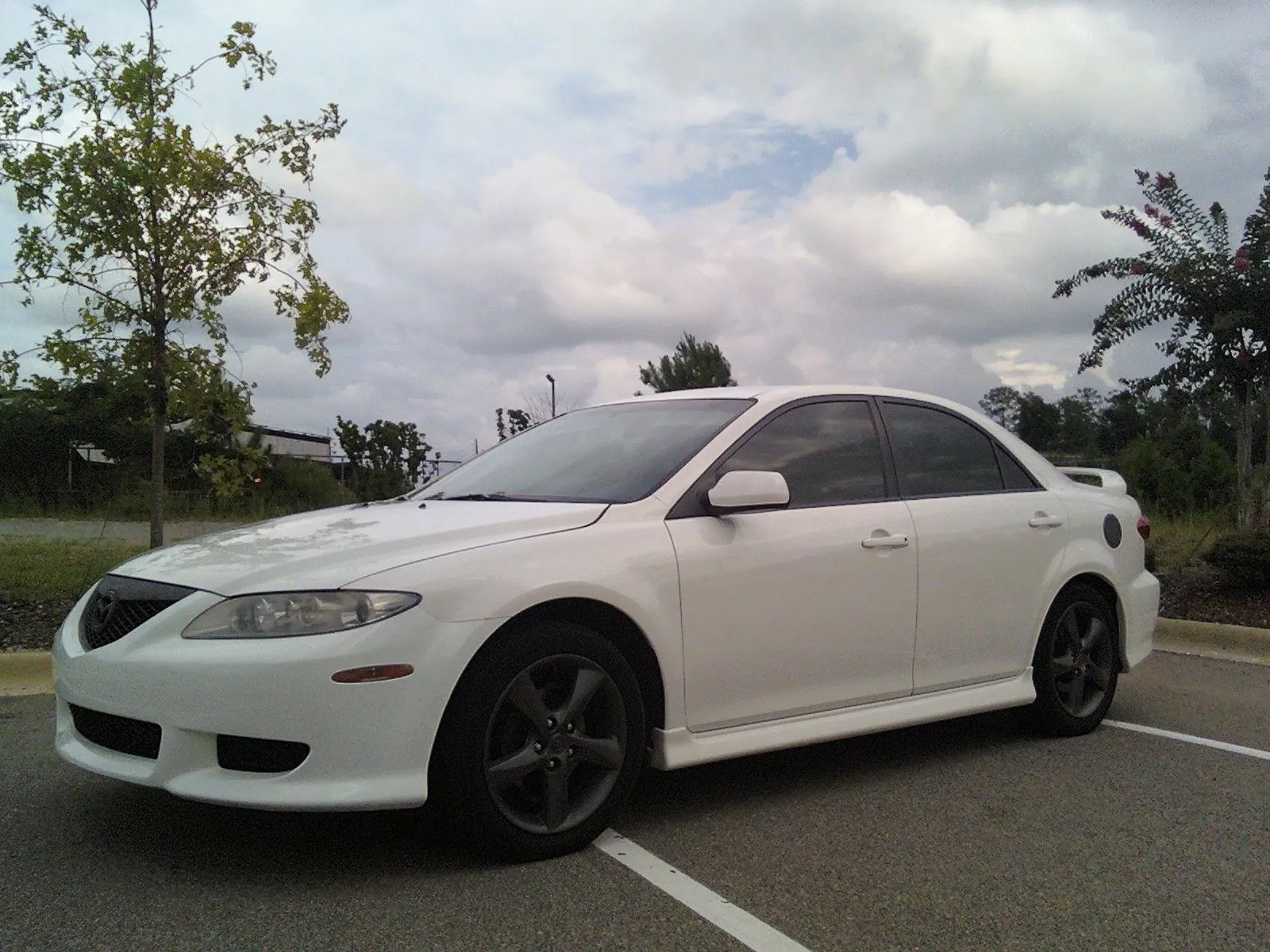

I took an extra set of 17" stockers from one of my 6's and followed the steps (applying a major amount of patience). Here is the result:

the process...
Well to be completely honest, the process started out with ALOT of help from the wife.
She got in there with me on the whole process so I can't thank her enough.
First, we used some "aircraft stripper" to really remove the stock coat. After that we used 3200 grit sandpaper and did the wheels on the inside and out. After that, we used an "Adhesive primer".
Some wet sanding after that then another coat of adhesive primer.
We let all the rims dry for a solid 24 hours and then wet sanded again and then began to apply the Gunmetal coats waiting an hour in between coats.
We applied a total of 4 coats the first day and then wet sanded all the rims the next day followed by 2 more coats.
The 3rd day we did a VERY LIGHT wet sand on them and then began to apply the clear coat.
We did a total of 4 coats in the next 8 hours and the let them dry overnight.
The end result is quite visible although I must admit the process was VERY draining and there are some minuscule imperfection but nontheless it turned out great and our next project is going to be picking up some Mazdaspeed rims and trying it on them.
The guys @ Advance auto parts were awesome in helping out and duplicolor paint was definitely the way to go.

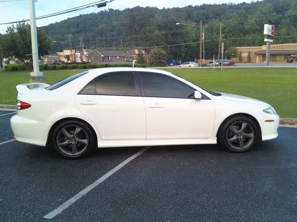

i got graphite which look perfect imo btw this pic may have a lil brake dust on them already but not much
