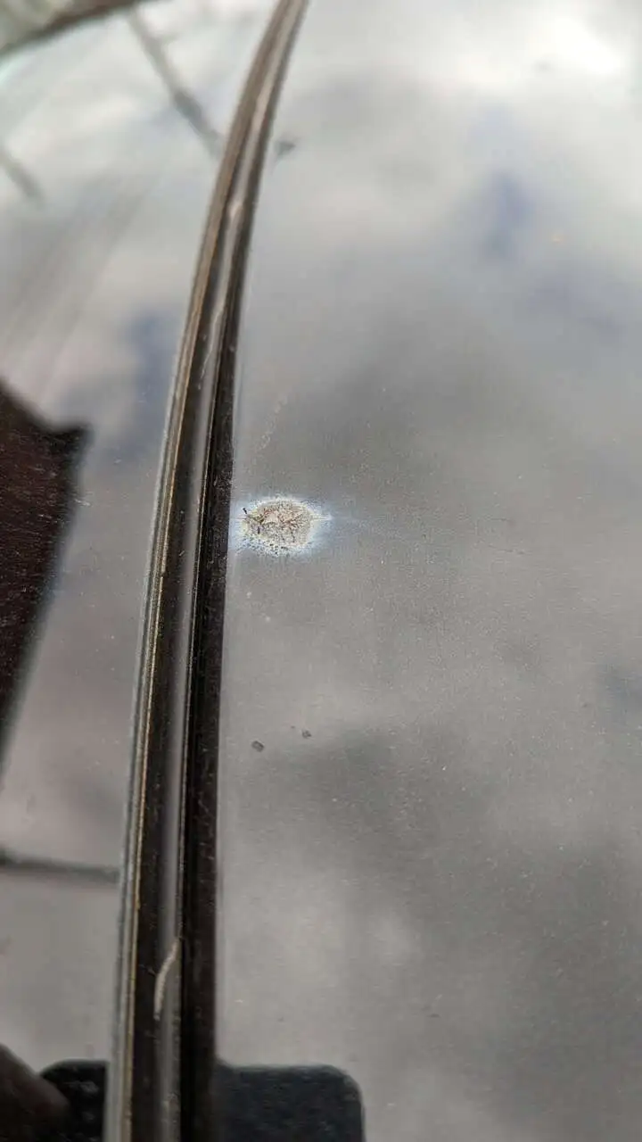

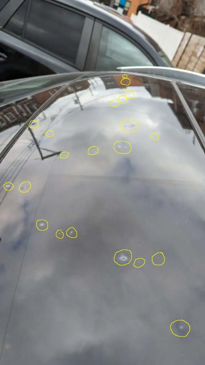

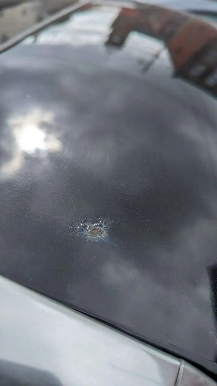

Spring is just taking hold and everything is melting. Went to wash the car and noticed today a fairly large area where the paint was bubbling on the panel between the windscreen and the roof. Went up to investigate further, and there are a good 25-30 other spots of paint bubbling or rusting of various sizes.
Is this a result of a factory paint failure on this panel? We are in an urban area, not driving on gravel roads. You have the regular small stones that pop up on the highway, but I've never encountered a situation where it seems like any little chip begins to rust like this.
The car is less than 4 years old. Hoping for some more educated opinions on this to assist in how to proceed, and if this is something I should push with Mazda to fix as it seems abnormal on a car of this age.

No, which is why I find this odd. Regular city driving. And well the hood has a few small dings from gravel/debris, nothing to the extent on this panel and none of them are rusting or look like they've gone that deep.
Just this one area that it seems any slight rock hit is penetrating the clear coat/paint down to the metal and bubbling up with rust.

Black actually, but I'll see what the dealership says about this and escalate if needed. It seemed unusual that so many would pop up over the winter.

Escalate for sure. This is a defect that should be repaired before the rust starts to spread.
Don't wait. It won't go away, that's for sure. Like I said in my case, there was no hesitation on Mazda's part.
Same thing happened to me with my 2014 gray CX5. Looks like you already have bubbling and rust. Down here in the states Mazda refused the claim, said it was road damage, had to get it repainted by putting in a claim with my insurance co.
The fact that it's only on the leading edge of the roof and not the rest of the roof is strange, especially when you consider that the hood doesn't have this damage. Seems like the roof paint is definitely defective, being more susceptible to rock chips than the rest of the car. Hopefully you can get this repair covered.

That's a totally different scenario. If there's no visible break in the paint, then yeah it's on Mazda. They painted over rust or some contaminant. As far as I can tell from the OP pics there appears to be a break in the paint, doesn't look like blistering starting under the paint with no external cause.
I might try and find the pics I took of my roof when I saw the rust spots. Hopefully I can figure out how to post them.
Also I took another look at the pics from the OP, and that's exactly how my roof looked, although some of his spots are more advanced than mine were. That is definitely a paint defect, and not road debris.
