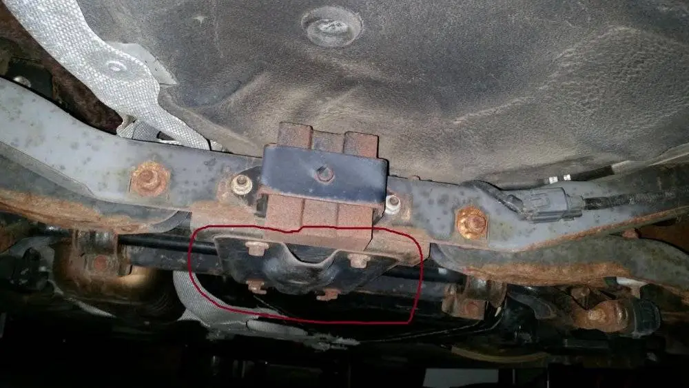

I had the exact same issue in summer 2020. Car did not move enough during lockdown and it was the Evap solenoid near fuel tank that seized with rust. It would move a tiny bit, but never fully closed like it should. You'd be able to blow through it while it was supposed to be sealed.
Trick I've found to save some cash while chasing these issues: Instead of throwing $$$ at brand new parts, I go in a pick n' pull yard and grab the usual suspects for next to nothing.
Grabbed both solenoids and a fuel cap for under 25$
Then you can start swapping parts around, after you bench tested them with a 12V source.
Look for the solenoid I'm talking about right in the middle of the car, under this plate.
