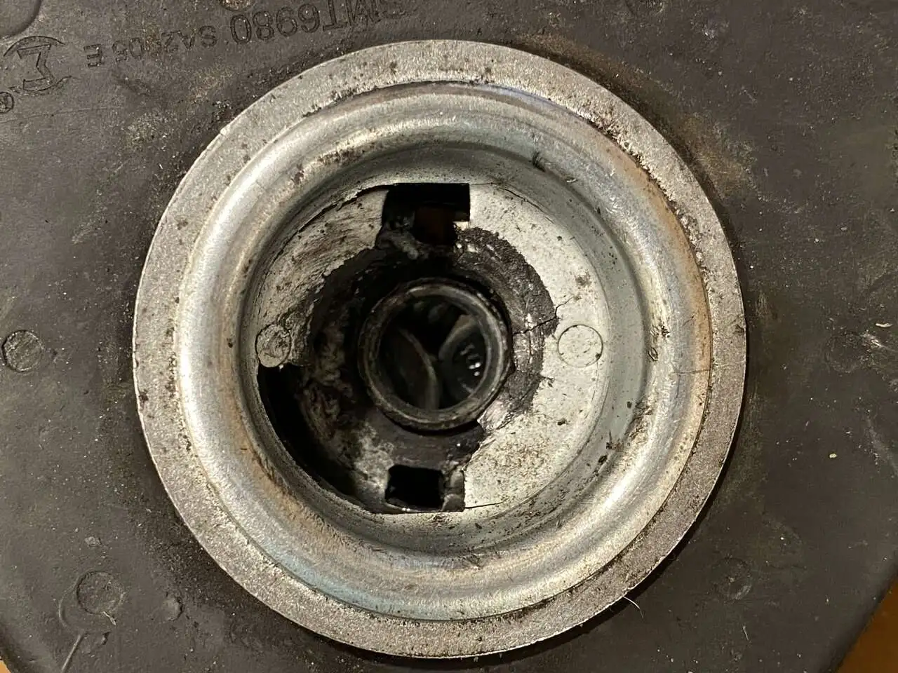

The only decent-quality replacement I could easily get my hands on was a KYB – which doesn't have the locating pin, so can be used on either side. An Autozone near me had one, so I could get it same-day. So, now I have one Sachs and one KYB strut mount. #ShrugLife
"Decent...."
Just over a year and ~20k miles. This was just a few days after we started hearing a noise; a few more at this rate and we might have put a strut through the hood. I am not happy.
FWIW, the Sachs mount on the driver's side seems to be fine so far. Fingers crossed...
This KYB one at least has a "lifetime limited warranty" from Autozone. But apparently the "warranty" is only good for one replacement, which kind of exposes it as a "we know this stuff is junk and are hoping only a certain percentage come back" kind of program.
I mentioned earlier that I had been having second thoughts about my brief foray back into potentially-less-than-OE-quality aftermarket parts. Now it's full-blown regret.
Never again – at least, barring a VERY compelling reason.
The cowl will protect the hood. In my case, it was due to user error. I did not use the supplied nylon lock nut and instead opted to reuse OE nut and didn't apply thread lock. Quite possible it was under torque too and over time the vibrations cause the nut to come loose and gradually caused my destruction. The steel on the KYB stop hat does look like a cheap/poor cast.
The cowl will protect the hoot. In my case, it was due to user error. I did not use the supplied nylon lock nut and instead opted to reuse OE nut and didn't apply thread lock. Quite possible it was under torque too and over time the vibrations cause the nut to come loose and gradually caused my destruction. The steel on the KYB stop hat does look like a cheap/poor cast.
Good point about the cowl. Sorry for how you earned that wisdom, but I appreciate you sharing it.
I'm really, really hoping the failure I had was from a defect in the casting rather than a weakness in the design or manufacturing. But either way, this whole experience has me considering preemptively replacing both strut mounts with OE (or equivalent if I can find one) in a year or so. I don't take kindly to structural failures, and my ego is bruised from having chosen to cheap out.
I had a hard time torquing the top nut to spec, so I doubled up on top nuts (the old OE ones plus the ones that came with the Konis). That seemed to hold everything in place pretty well, so I did it again (plus blue Loctite) this time.
Bumps are audibly noisier on the passenger's side (KYB strut mount) than on the driver's side (Sachs strut mount), and the passenger's side sometimes makes a slight groaning noise when steering....

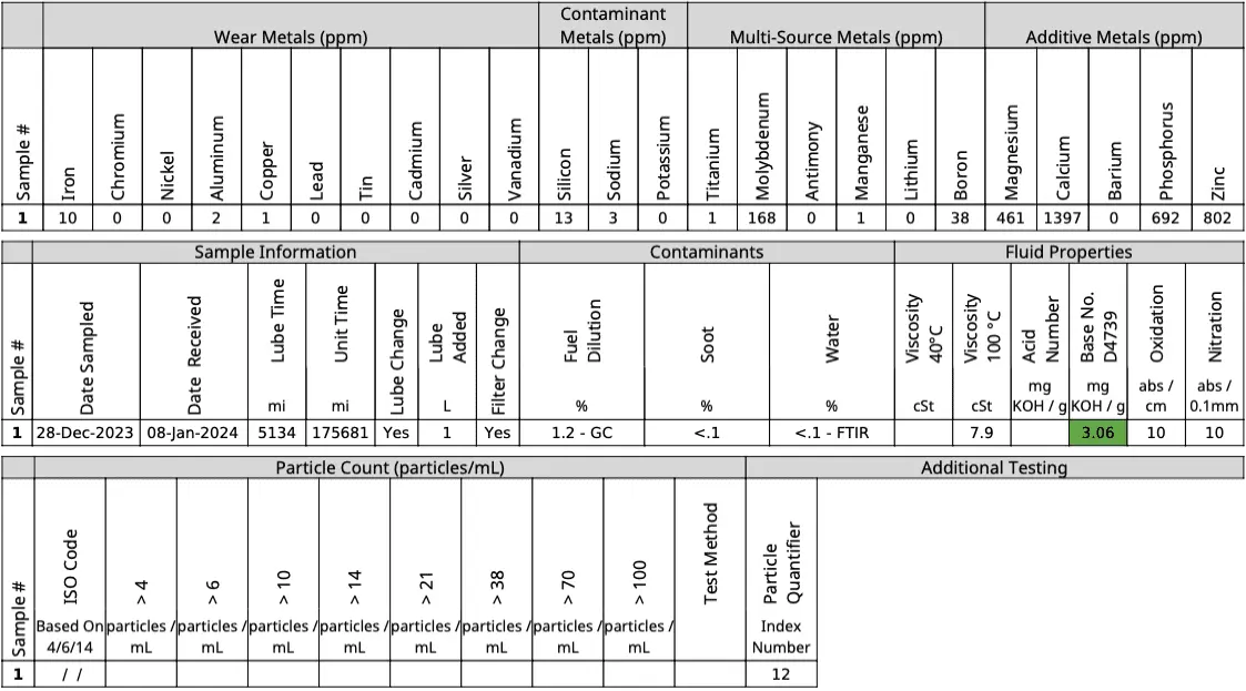

Finally did my first used oil analysis on this engine!
It's had a few oil changes since I bought it, but those didn't make sense to sample because they weren't all under my control and didn't all use the same oil. I plan to stick with this oil for the foreseeable future, mainly because AFAIK it's the most appropriate 0W-20 that FCP Euro sells (sticking with them for their Lifetime Replacement Guarantee).
I assume this vehicle was meant for people to putter around rarely exceeding half throttle or like 3k RPM. That's.... not what I do. I have zero reservations about going WOT and making the needles swing when it's safe – which is fairly often given how slow this thing is. I do try not to let the revs get past 5k because I assume this engine wasn't meant to spend much time up there; this means I basically never let it make peak power (159 hp @ 6k RPM). I also drive gently and keep the revs low until the "cold coolant" light goes out (it doesn't have an actual temp gauge). But when merging on a highway, or when the road ahead is clean and clear and visibility is good, the loud pedal goes right to the floor and doesn't come up except to shift.
Given that, I have no way to understand how low these wear metals look. I did add 1 L of oil pretty close to the end of the OCI, which isn't insignificant given that an oil and filter change takes 5 L. But even if I multiply all of the wear metals numbers by 5/4, they still seem incomprehensibly low to me given the mismatch between my usage and what I assume the engine was designed for.
As with all oil analysis, low numbers on a single report don't necessarily mean all is well. But they still seem crazy to see. Maybe I'm underestimating this engine.
Nominal starting TBN on this oil is apparently 8.7, so seeing 3.04 on this report makes this change interval (~5k miles) feel good to me. Enough reserve capacity in the oil that I don't feel like I'm running it too long, but not so much that I feel like I'm wasting it. Also nice to see TBN being the limiting factor rather than something else.
Screen clip of the report is attached, but I've transcribed the numbers because I don't think the report's formatting works well in this context.
Wear Metals
Iron - 10
Chromium - 0
Nickel - 0
Aluminum - 2
Copper - 1
Lead - 0
Tin - 0
Cadmium - 0
Silver - 0
Vanadium - 0
Particle Quantifier (PQ) Index - 12
Contaminant Metals
Silicon - 13
Sodium - 3
Potassium - 0
Multi-Source Metals
Titanium - 1
Molybdenum - 168
Antimony - 0
Manganese - 1
Lithium - 0
Boron - 38
Additive Metals
Magnesium - 461
Calcium - 1397
Barium - 0
Phosphorus - 692
Zinc - 802
Other Contaminants
Fuel Dilution - 1.2% (GC)
Soot - <0.1% by vol.
Water - <0.1% by vol. (FTIR)
Fluid Properties
Viscosity @ 100º C - 7.9 cSt
TBN - 3.06
Oxidation - 10
Nitration - 10

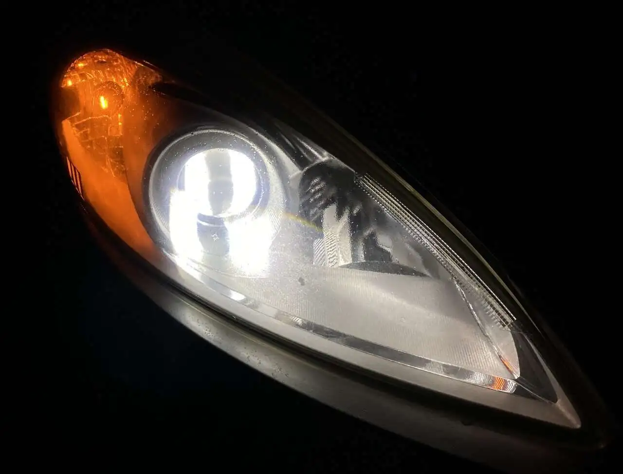

Been doing a lot of reading on headlight upgrades for our M3. Part of that process has been finding out how catastrophically wrong I had been about the wisdom of upgrading halogen or HID headlights with LED bulbs:
Maybe that's why I just started noticing this – though I feel a bit silly for not noticing it earlier:
See that vertical stripe? That's from the blade of an LED bulb. This is a Morimoto 2Stroke 3.0, a tier-1 bulb if there is one (with a price to match). It doesn't get much better than this, if at all. All their marketing material insists this bulb replicates all the necessary parameters of the stock beam pattern, and I've been happy with its output.
If even this bulb has that visible oddity, I can totally see why people who really know automotive lighting are horrified by LED bulb upgrades. This projector's optics were designed around a small 360º light source (the halogen bulb’s filament), and even this – the thinnest possible blade – very clearly isn't one. The net result might still be acceptable, but there's no way the hot spot, scatter, etc. are exactly like stock.
If anyone's wondering why this bulb uses a bladed design rather than a ring or cylinder of LEDs or something, it's because shapes like that are actually worse: Why You Should Avoid Multi-Sided LED Bulbs | Headlight Revolution
I have half a mind to drop some halogens back in for an A/B test. Maybe these LED bulbs aren't as good as I had thought they were.
If nothing else, this really drives home all the LED bulb swap horror stories I've seen in YouTube videos and read about online – poor beam pattern causing worse visibility even with greater output, etc.
