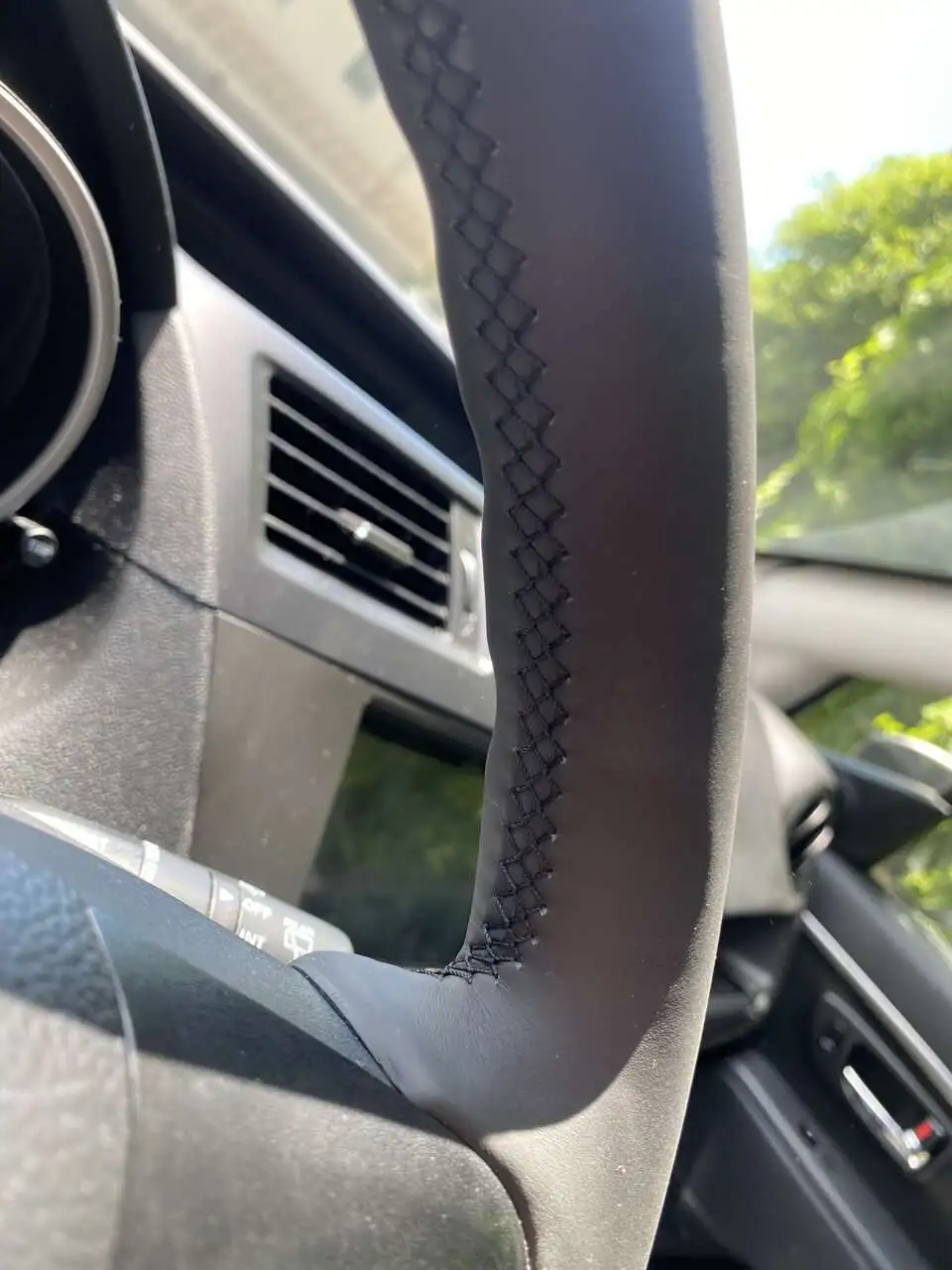

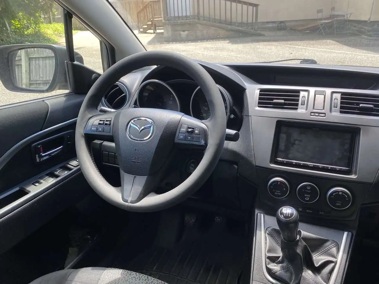

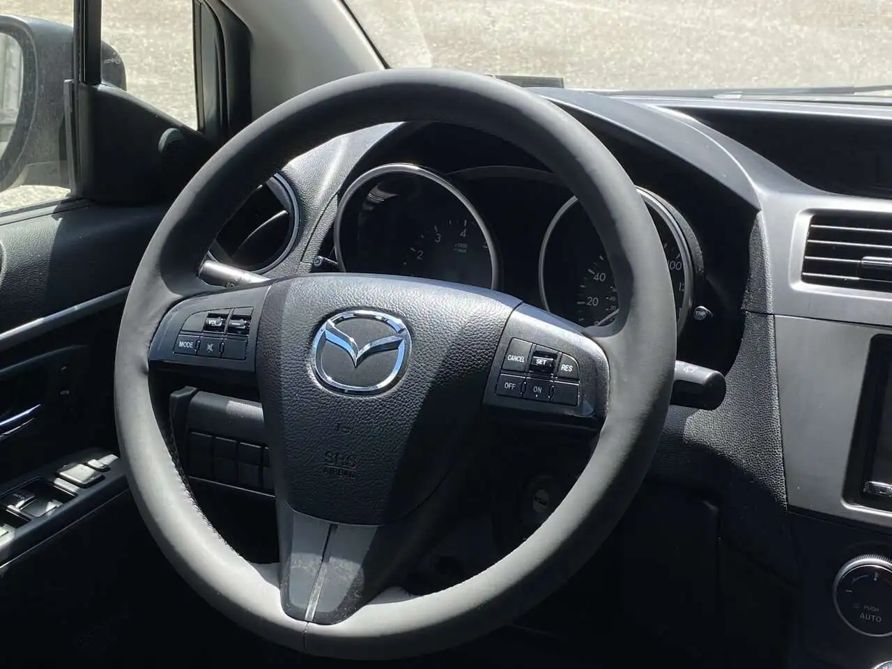

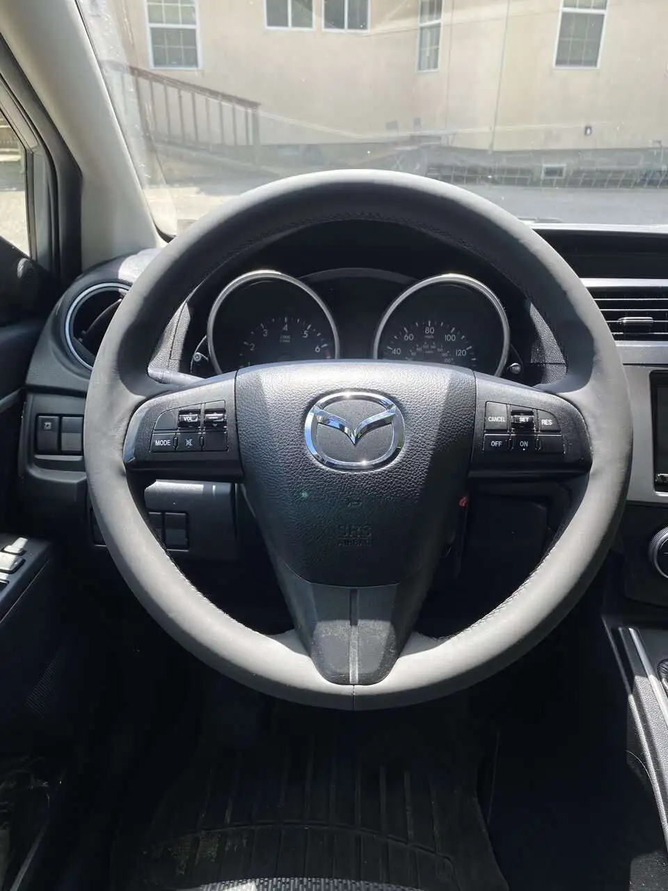

Nice quality-of-life upgrade: custom leather wrapped steering wheel by my buddy! (IG: @chesis300)
Could have had any of a wide variety of materials and colors. Would have loved Alcantara with thumb grips, but wanted something simple, anti-pretentious, and easy to clean. Even opted for black stitching to keep it as low-key as possible.
Amazing what a difference a good-feeling steering wheel makes. It's a small thing but you feel it literally 100% of the time you're driving the car. Low effort, low expense, high impact. Strongly recommended.

No Alcantara, you are slumming it... Leather wheel does make a big difference in your hands.
How much did that cost ya? Is there a reason why you went this path vs pulling/ebay a complete OE leather wheel off a comparable Mz3/Mz5 GT or MS3 car? Cheap (b/c reuse airbag) and easy, has better fit and finish, and OEM leather is actually pretty good/durable.
Alternatively, a complete latest gen Mz3/CX-3/CX-5 (hex shaft mount) GT OEM steering wheel looks much better, leather, has thumb nub, heated, has more buttons/functions for your aftermarket radio (not that you need/want it, via Axxess/iDatalink/PAC/Android/etc). Clock spring & airbag connectors 'appear' to be the same and betting still resistance base triggers, but cannot confirm 100% since I only looked into as a curiosity. Will need minor wiring&button to turn on heated wheel. The biggest cost is needing a new airbag but you can 'try' to look for auction listing and sell your airbag to offset cost.
They start at $325 shipped + refundable core deposit if he has a steering wheel core in stock. No core deposit if you send the steering wheel. With options they go up to $500+.
This was a "congrats, you bought a car" present from last year that took me until now to install.
I like that it's thicker than the OE steering wheels, though. I like a chonky steering wheel.

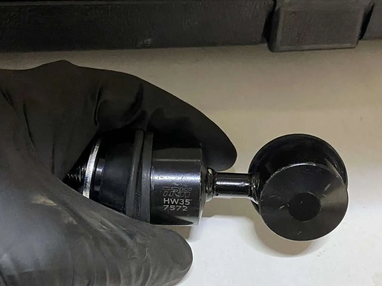

One of the rear ARB end links I installed just last year – the driver's side one – already started making noise:
I expected more from TRW.
Replaced it yesterday and all is well. Glad it's such an easy job.
Noticed different markings on the old one (the one that went bad in less than a year) and the new one.
Old:
New:
#ShrugLife

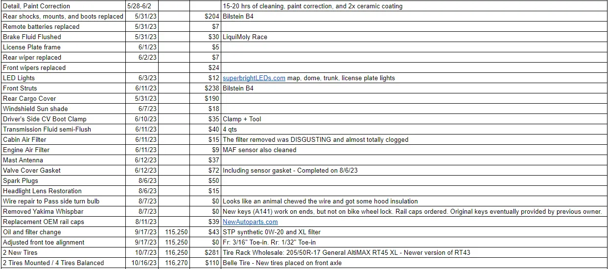

Here's what I've done so far:
