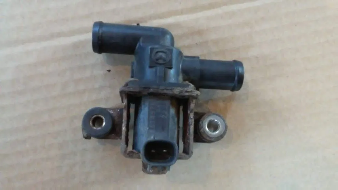

In my case, it turned out to be the canister vent solenoid which is located at the rear of the car, directly above the center jacking point. You'll see the charcoal canister up there too. Just two nuts and two hoses to get the solenoid off. There is a hole in the jacking plate you can put a socket extension through, and I got the second off with a socket swivel.
Replaced with Dorman 911711 from Rockauto, $44.
The way I tested the old one was to remove it and apply 12v to the connectors. Although it clicked really well, I found I could blow a tiny amount of air through it in the closed position, so I crossed my fingers that this was the problem and replaced it.

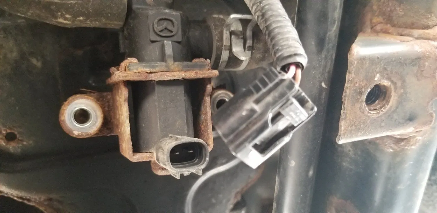

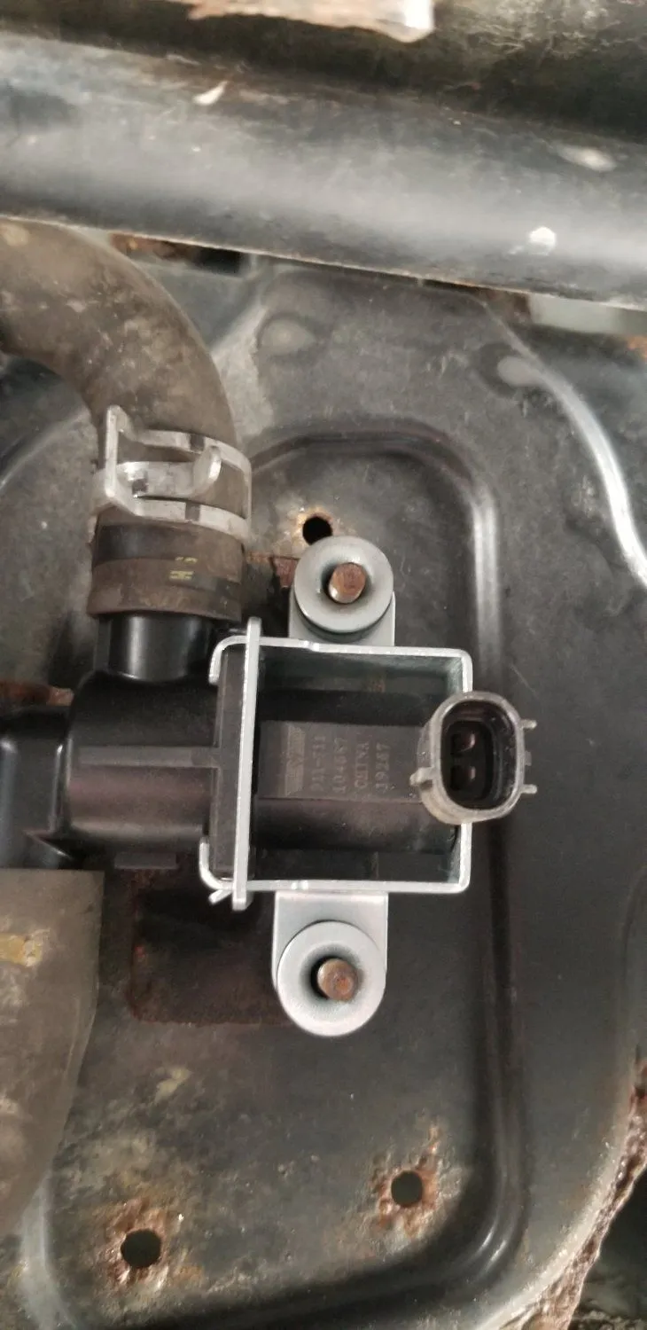

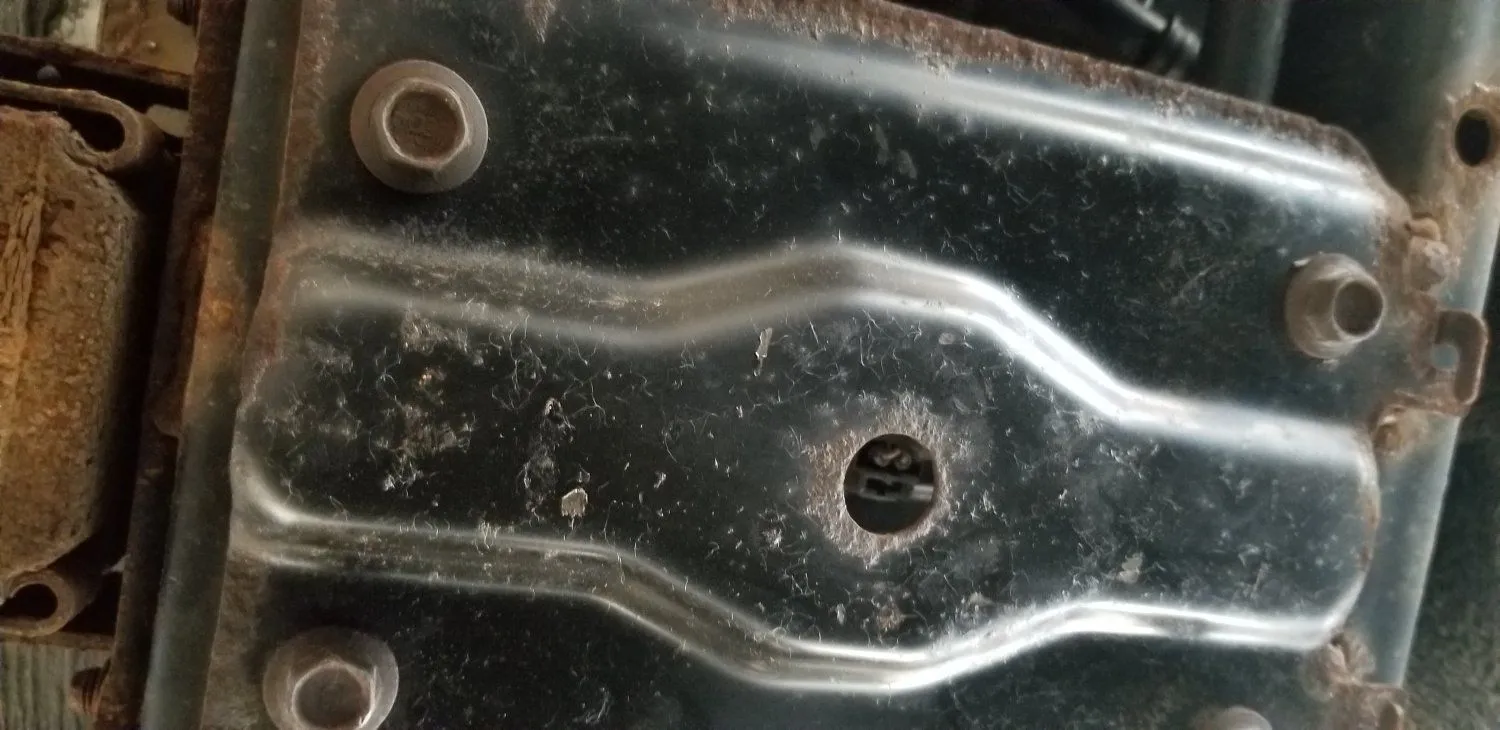

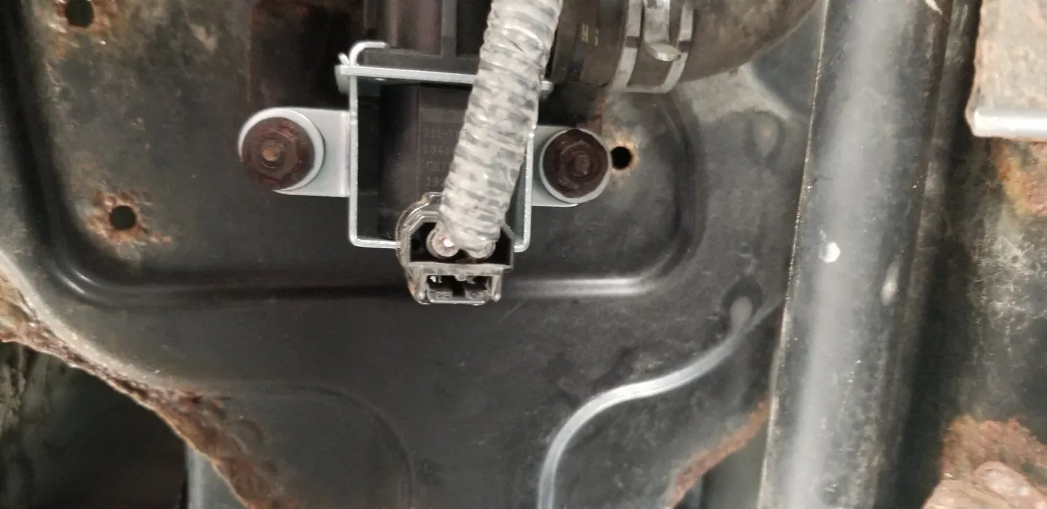

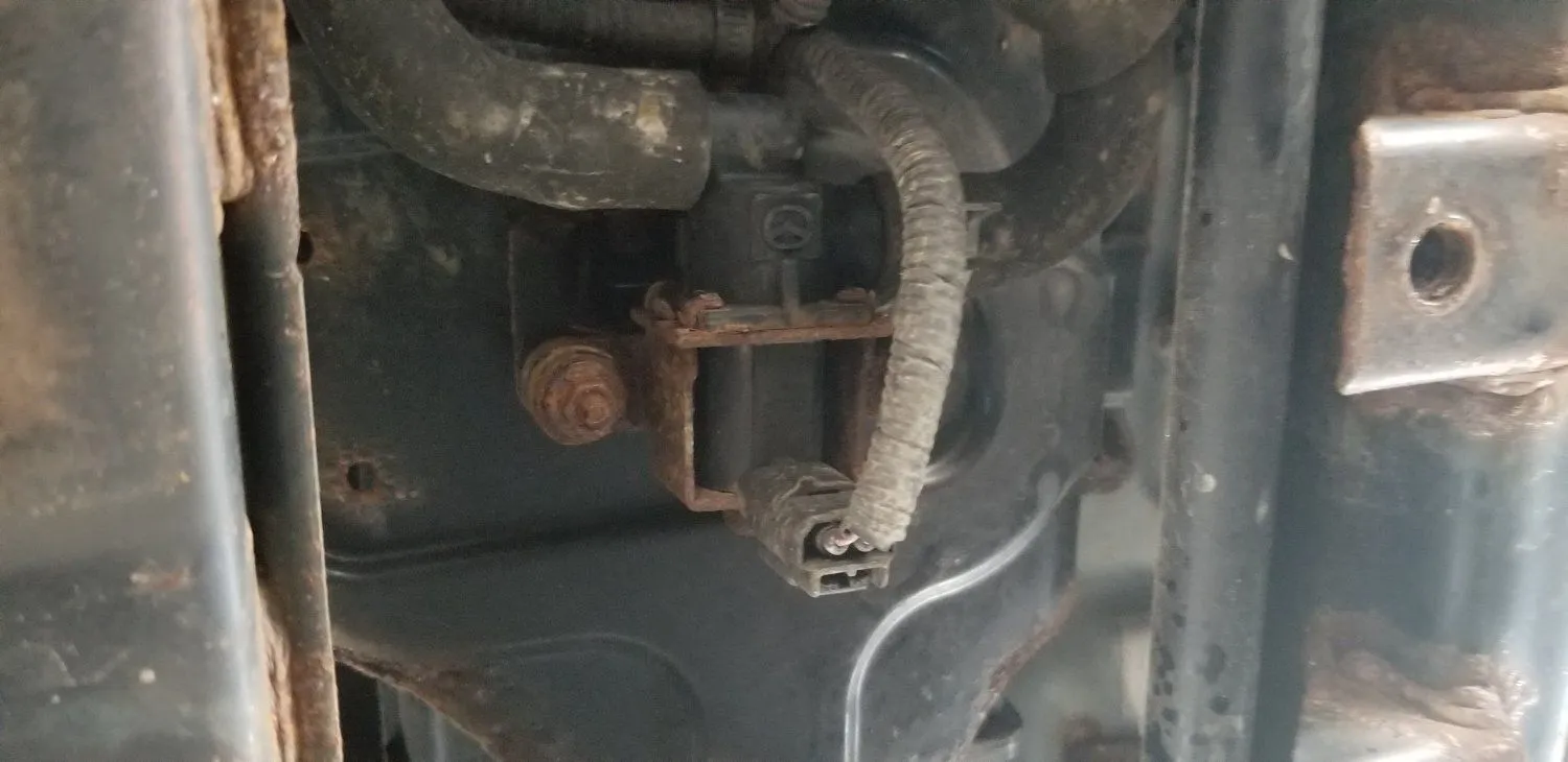

Hey Dougsey, just to follow up from the other thread about removing the rear jack plate, no issues at all. Much easier to deal with the plate off.
Just need some PB Blaster and let the four bolts soak for a couple hours, 14mm impact socket for the jack plate bolts, 10mm deep socket for two bolts on value, screwdriver to separate clip, and a wrench to pop off the clamp.
Thanks again for your assistance!
