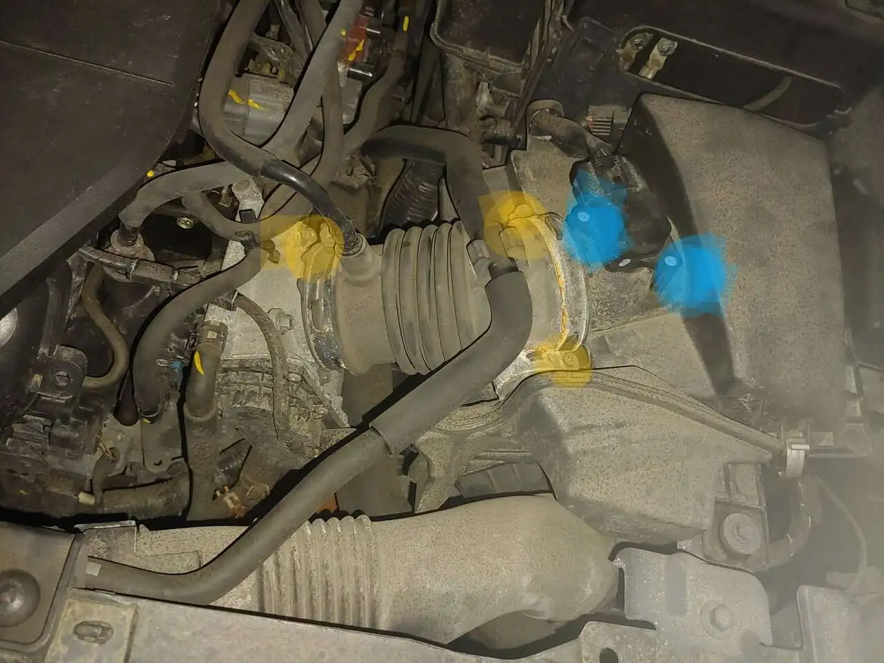

3 Intake clamp screws are highlighted in yellow. Check the 2 screws for the Mass Airflow Sensor highlighted in blue to make sure they are tight. Don't overtighten the 2 screws highlighted in blue as it is plastic you are screwing into and it could strip the holes. I fill up with 87 for gas and after filling up, I would have to press the gas when starting it to get the engine going. Not good for the engine but it was the only way. After that it starts fine till I had to fill up again. Doesn't do that anymore after tightening the screws in the picture above.
