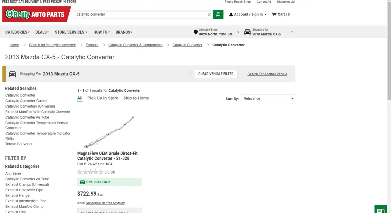

152k. this is the CAT that was installed.

Someone suggested it could be the front catalytic converter built into the exhaust manifold.
I really don’t believe CX-5 uses 2 catalytic converters. Usually with P0421 at your 152K miles, you need a new catalytic converter. Unfortunately a quality CC is too expensive, and the cheaper one may not good enough to get rid of the CEL. Oxygen sensors are similar. Inferior sensors may trigger the P0421 too. And Denso oxygen sensors are the ones you want to use. People dump CC cleaner into the fuel tank、submerge entire CC in a bucket of cleaner、replace oxygen sensors、replace catalytic converters (in sequence) and try to get rid of the P0421 but sometimes just at no avail. Like your mechanic I simply don’t know what is the next step you can do other than spend more money with OEM oxygen sensors and OEM catalytic converter which of course would cost you a lot of money but no guarantee.

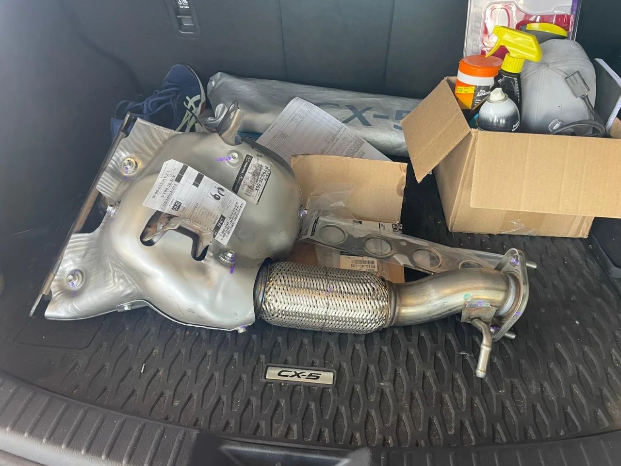

Mazda CX-5 has two catalytic converters. The exhaust manifold has an integrated catalytic converter and this is the one monitored by the O2 sensors. As a matter of fact, if you look down into your engine bay, where the upstream O2 sensor is installed, the cat is right under that shield. I've had the same code P0421 (2020 Mazda CX-5) for few months and tried all the things mentioned above but I ended by replacing the exhaust manifold with the integrated catalytic converter. I am almost certain that your Mazda needs a new front cat. See the picture. And, needless to say, my car runs like new.
Yea, im certain I need one too. But honestly at 190k miles, I don't know how long I'll keep the car.
