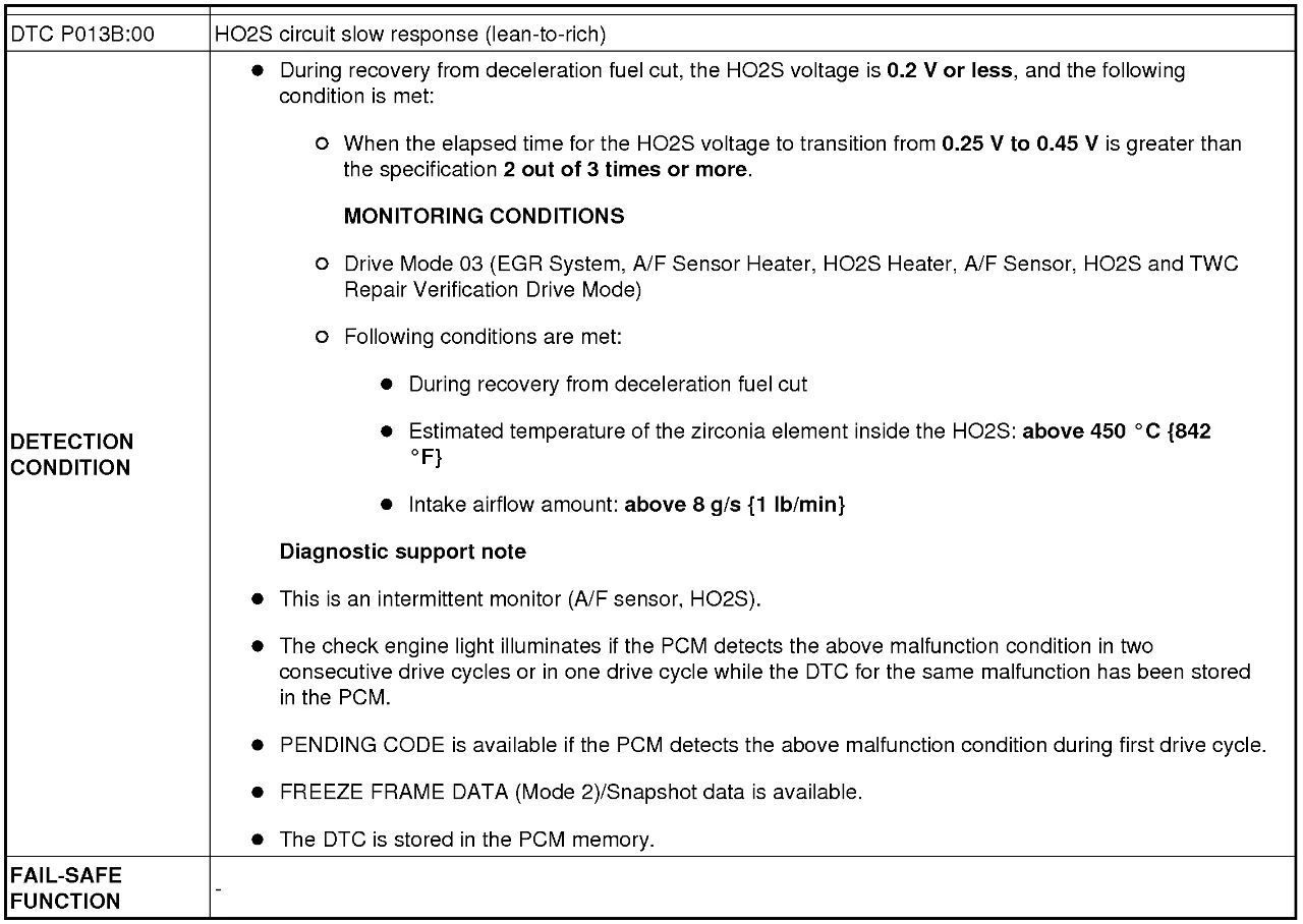

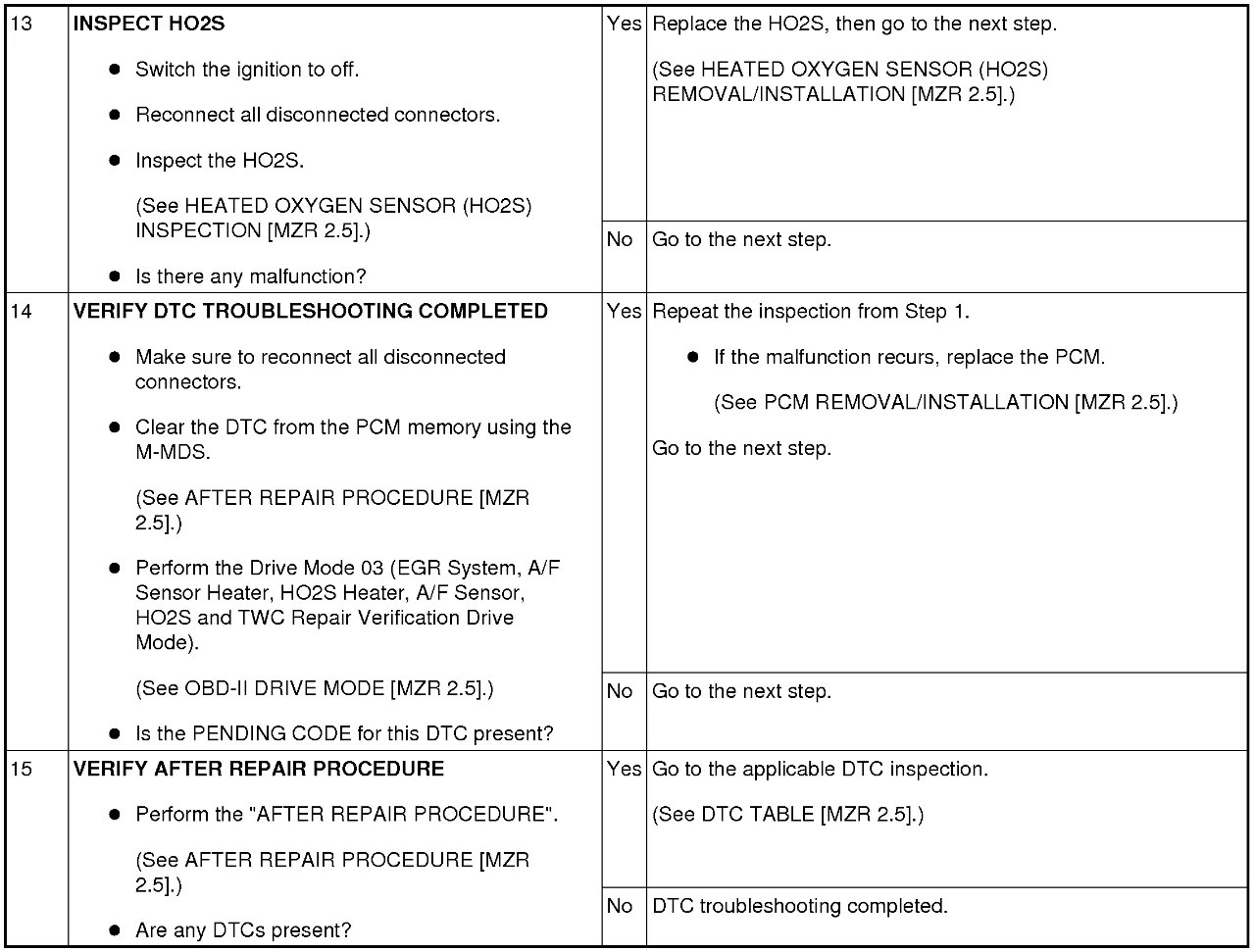

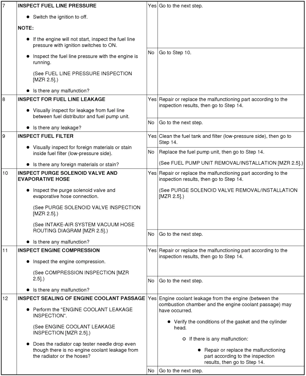

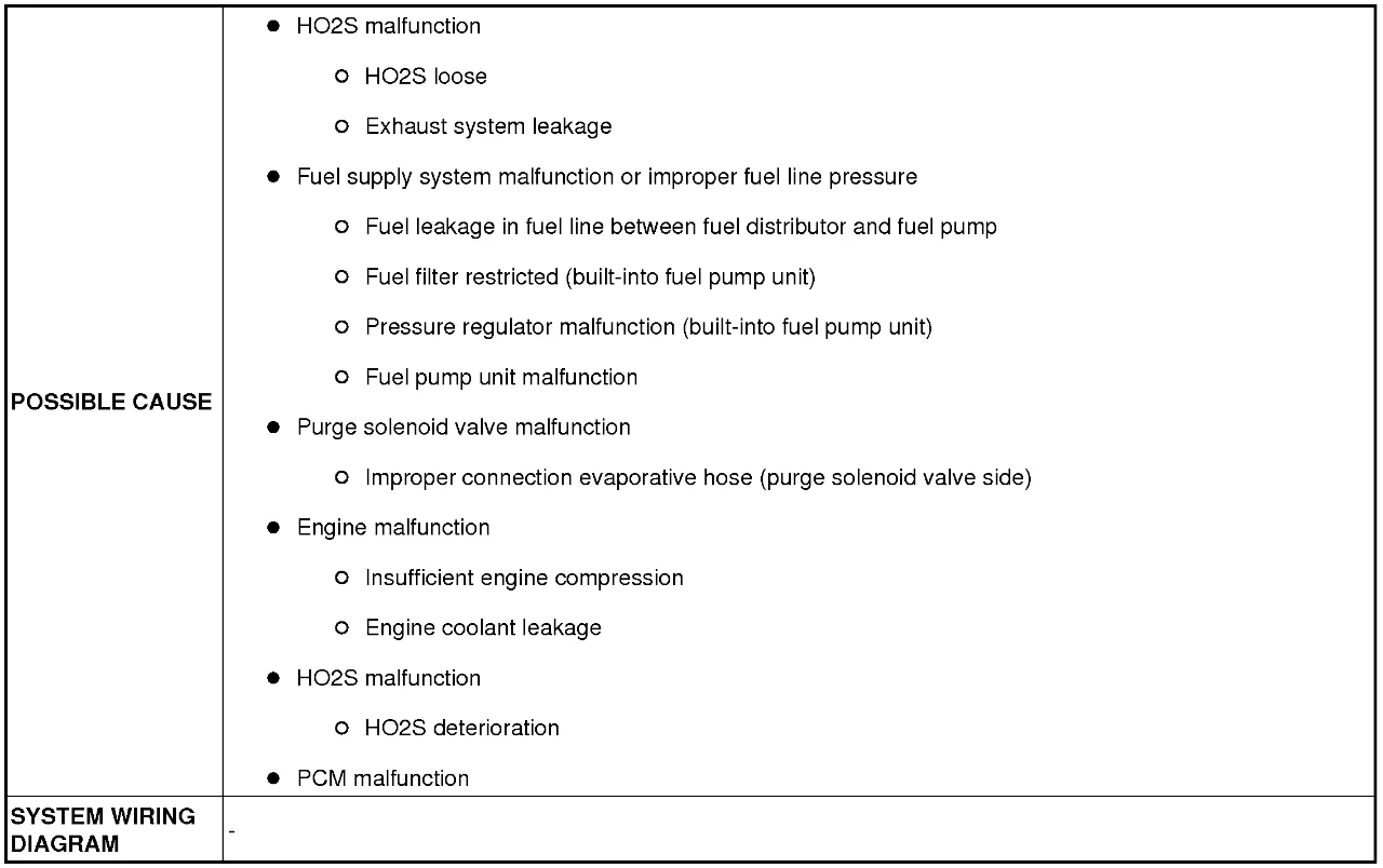

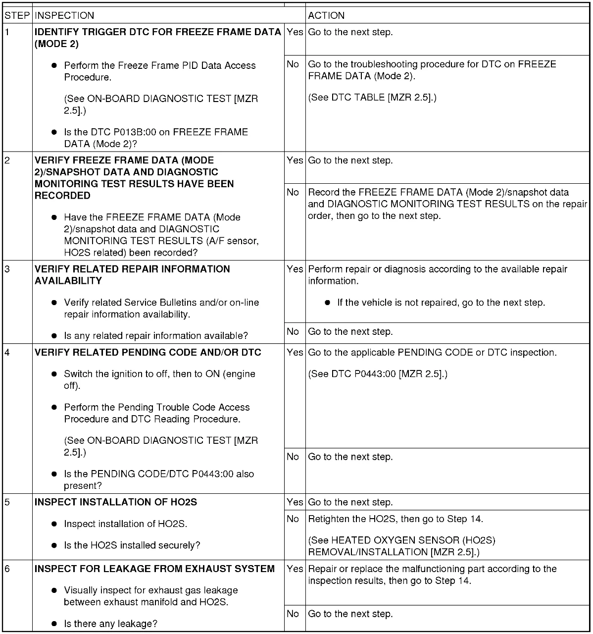

While researching online, I bumped upon a very detailed action diagram of what to check in what order for what code - but for Miata. I wish such thing existed for 5.
Actually, I found it! And you were right, it's the downstream sensor.
