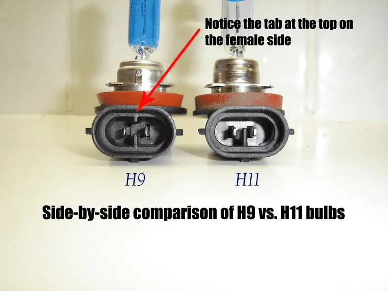

I use Philips Standard bulbs, but instead of 9005's, I use https://www.amazon.com (commissions earned)'s. And instead of H11's, I use https://www.amazon.com (commissions earned)'s.
Go that route, I promise you won't be disappointed. These bulbs are still halogen, but a different type of halogen. The 9011's are HIR. No, not HID, HIR. Halogen Infrared. Because they're halogen, they behave perfectly in our factory housings, no mods to the housings whatsoever.
You will have to *slightly* modify the bases of the bulbs with some wire cutters or maybe even some fingernail clippers, but it's easy, and well, well worth that tiny bit of effort.

You are correct. To do a *proper* retrofit of either LED or HID, you are required to install new housings. There is exactly *one* ECE legal LED that can be placed into a Halogen housing, and that's the Osram Night breaker LED H4. But we don't have H4 housings, so that's a moot point.
Get the H9/9011 halogen combo I was talking about. You will be pleased, I promise.
OK, what exactly did you clip/cut off?

H9 mod
9011 mod
