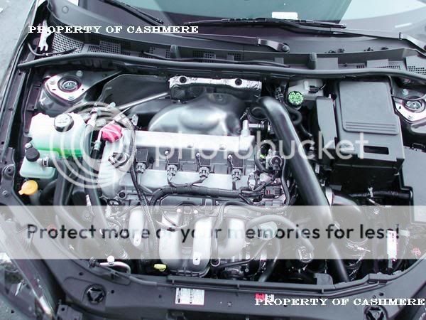

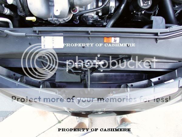

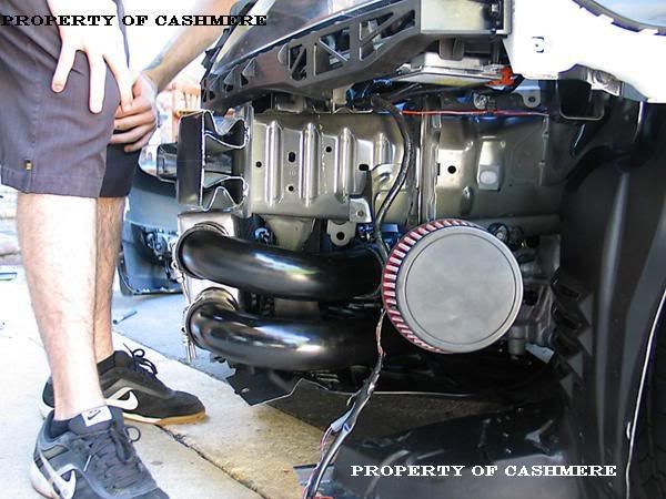

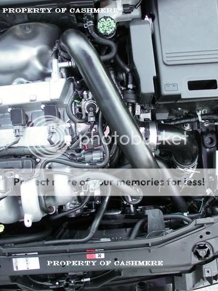

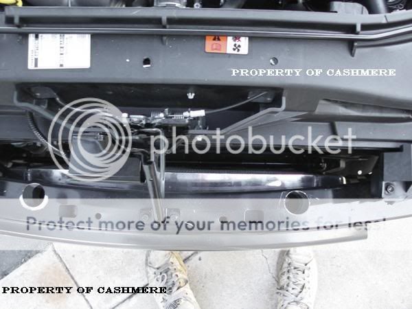

I hope you don't mind cash, but I think you made it too stealthy!!!!
For the finished look, see post #16.... geez guys...
BTW, this was all handbuilt by cashmere and his buddies!!!! AWSOME WORK!
