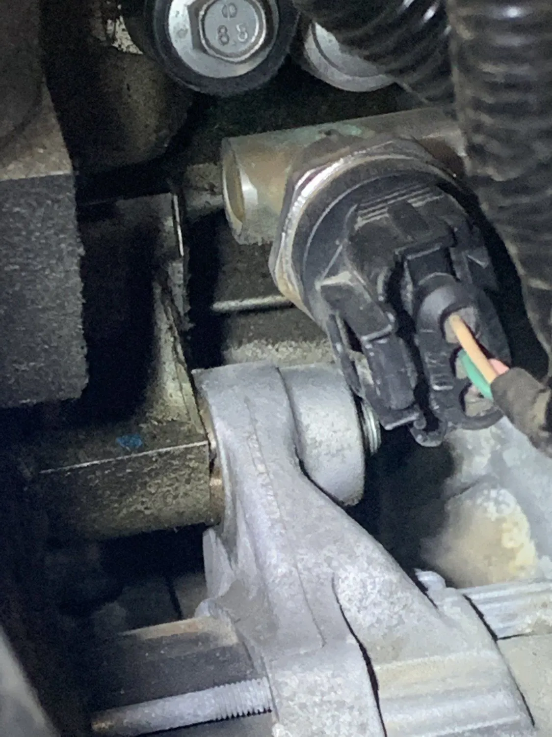

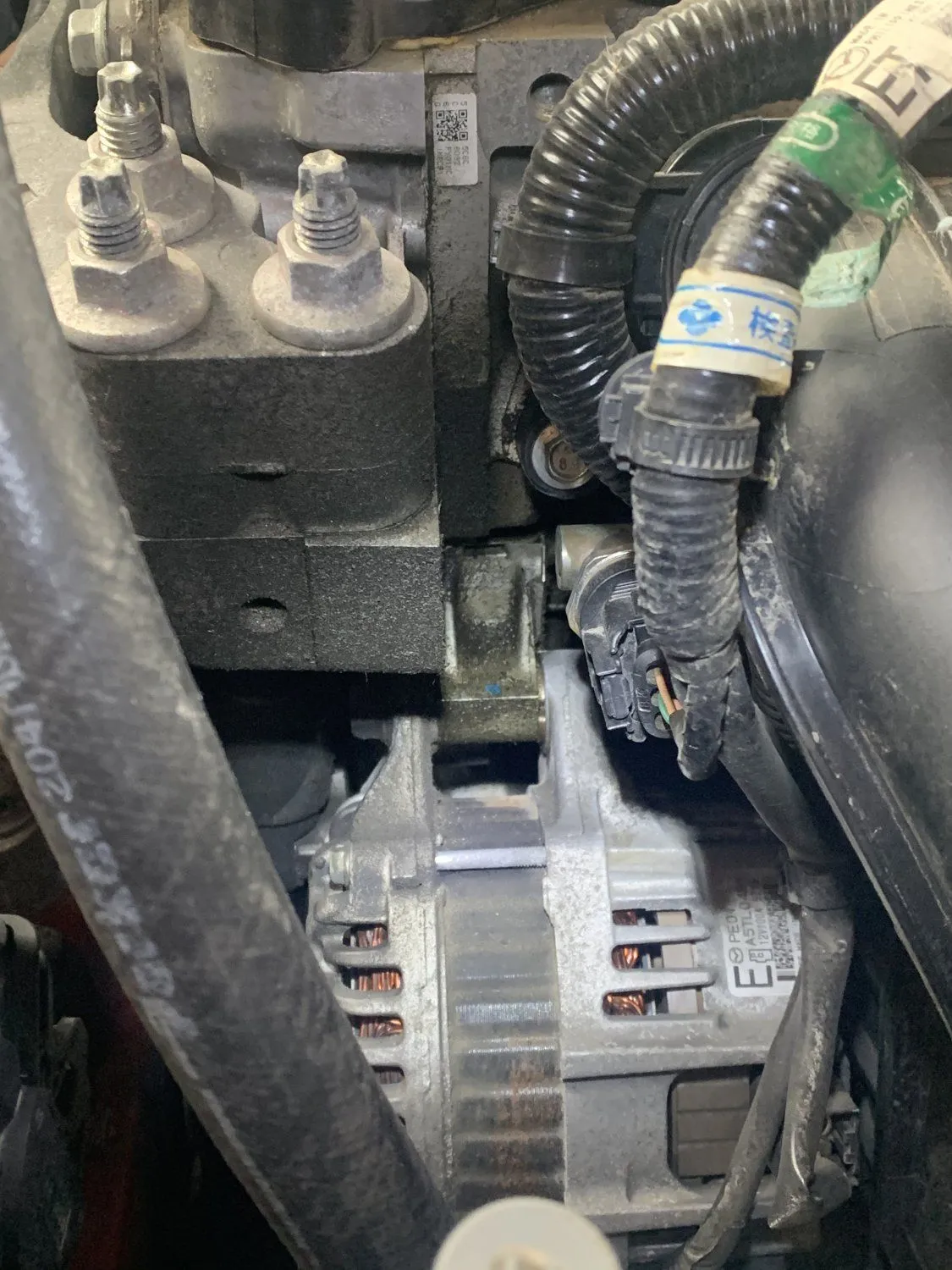

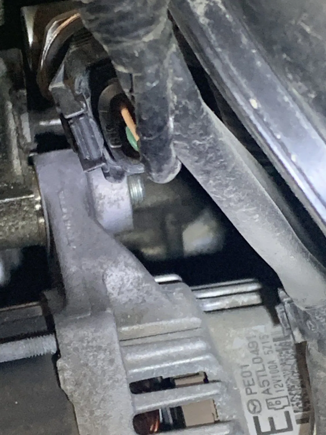

Good morning folks.
Did a once over of the engine compartment this morning and noticed some seepage coming from above/behind the alternator. Valve cover is clean and from what I can tell, the intake manifold looks solid as well. But it does appear to be coming from, or is most expansive directly below the manifold on the block, so perhaps that is truly the source. When I get some time I'm going to clean up the area (just cleaned the engine bay 2 months ago...) and start tracking.

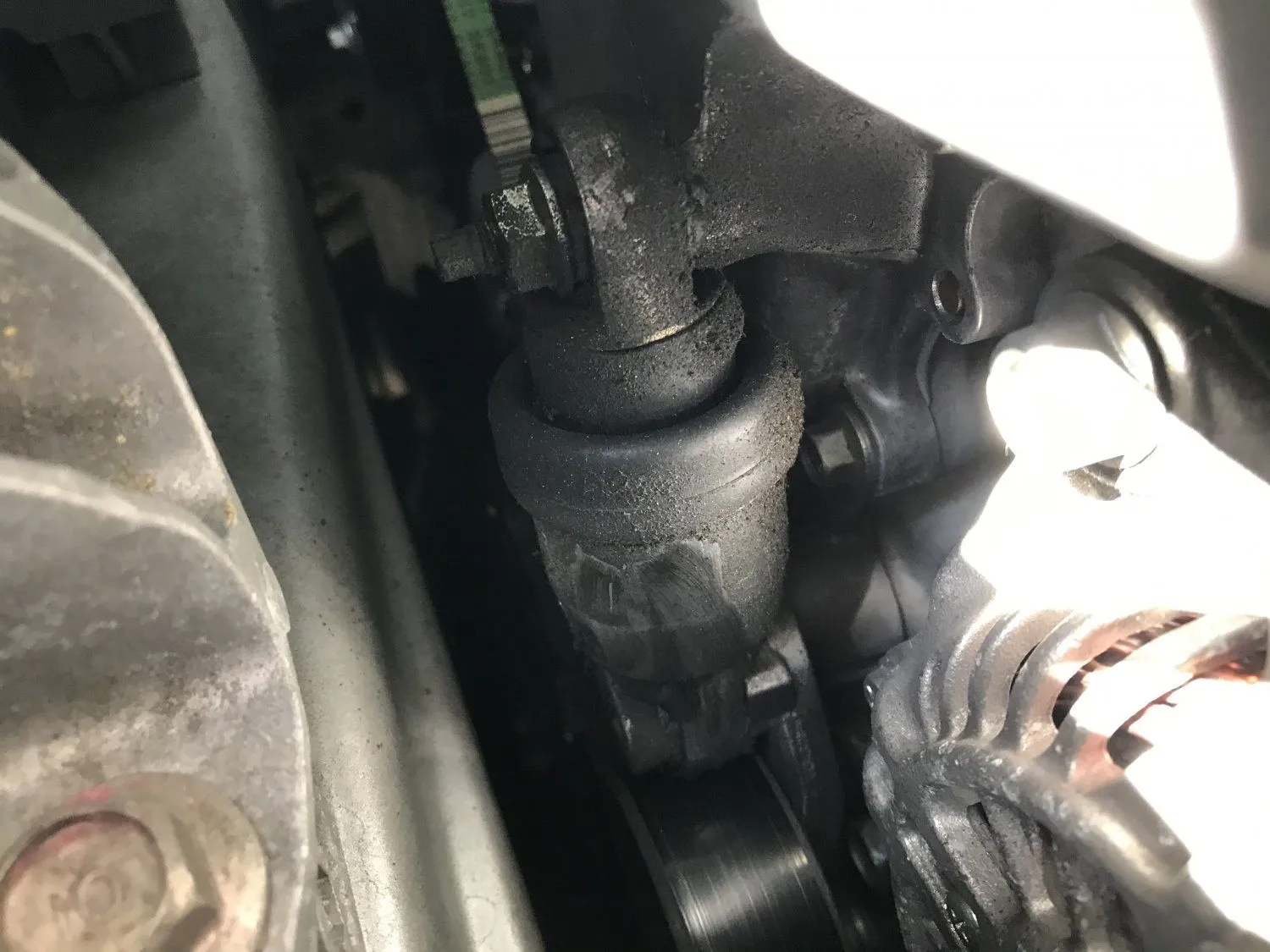

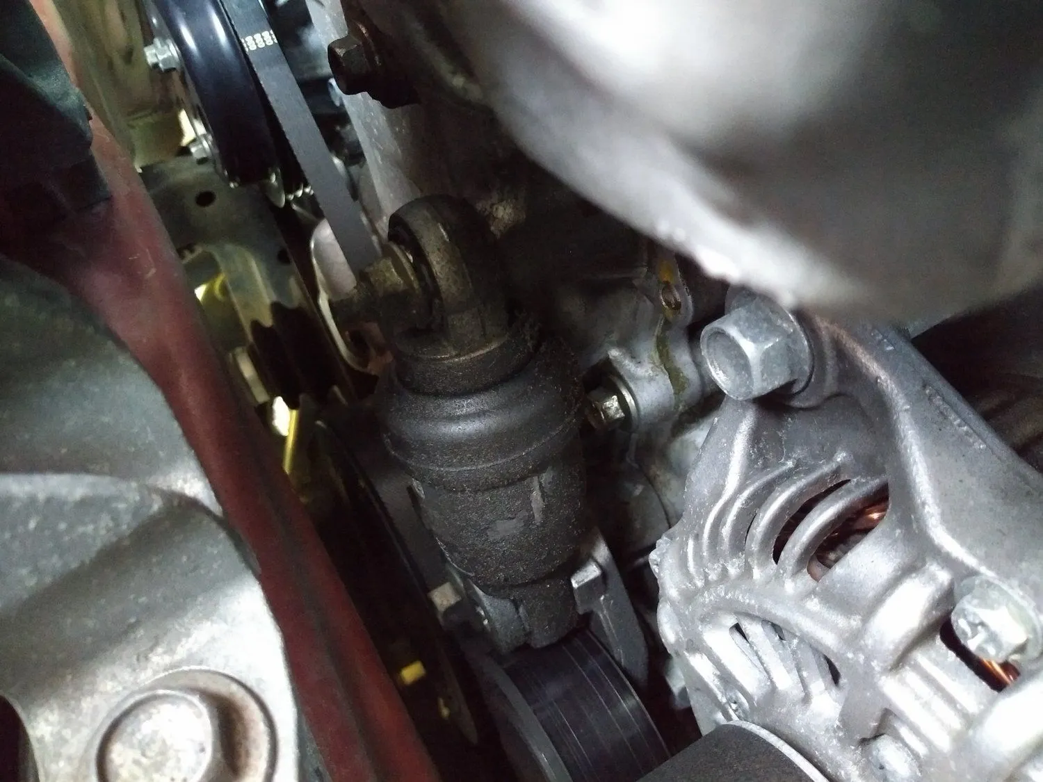

Granted, they're not the best pics, but I was able to get these during my rush this morning. Bonus shot of the tensioner for good measure, a little dirty (you can see my finger swipe) but doesn't appear to be leaking like so many others. For those curious, car has just under 72k miles on it. What are your thoughts?

Based on seepage area, my guess is the timing chain cover leakage which is pretty common problem for CX-5 2.5L. There’s a TSB for the problem, but it’s hard to fix even if the dealer is following the TSB procedure.
Timing cover seal and coolant flange issue
Small Oil leak for me too... :-(
Might be tensioner too
IMO, tensioner fluid is much thicker and the leak should cover much smaller area if any.
It does look like timing chain cover.. mine leaks on the back side while this one looks to be on the front.
That’s what’s throwing me. From what I’ve seen of the timing chain leaks, they’re actual leaks that result in oil buildup on the back and bottom.
The tensioner isn’t leaking, and if it were, it should be more isolated.
I’m wondering if I’ve got an intake bolt causing the slow leak. I’m not concerned with the seepage, but would be nice to figure out the source.

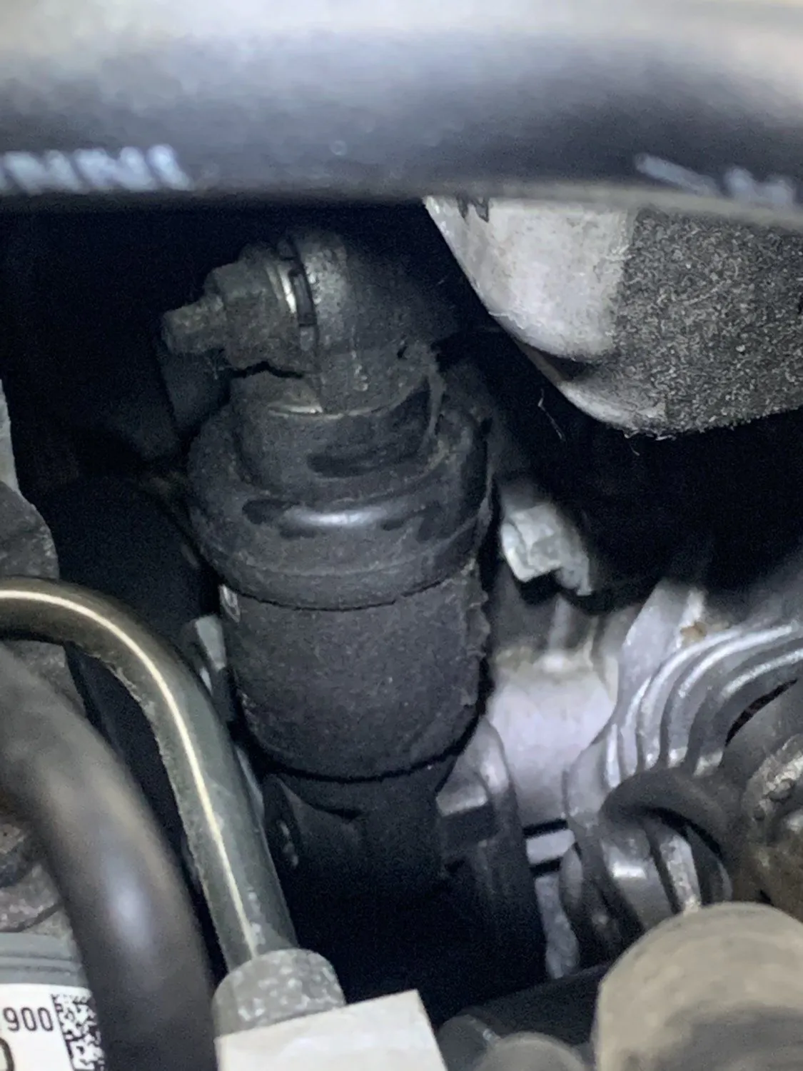

actually, it looks like it could be the timing chain cover and the tensioner. do a finger swipe on the main body of the tensioner below the rubber portion. if it is a thick, black, oily dirt, then it's leaking
My second CX5 and my second belt tensioner leak at 43000 miles, so much for their improvement over the previous one.
madar: ironically the leak I have never had.
Don’t know what has the OP found about his oil seepage problems. But looks like OP’s belt tensioner is leaking too like madar’s!
Well, I checked my belt tensioner today and it’s leaking too! My 2016 CX-5 is at 41,150 miles and I was a bit surprised as I checked the tensioner at beginning of this year at 40,500 miles and the metal body of the tensioner was bone-dry.

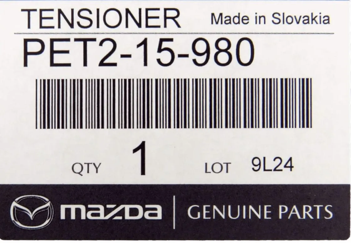

there have been i think four revisions to the tensioner. the newest one is part number: PET2-15-980
The list price for PET2-15-980 is $147.86. That’s pretty high IMO with this kind of quality. And yes, there’re so many revisions: PE01-15-980A, PE01-15-980B, PE03-15-980A, PE03-15-980B. Hopefully this latest revision, PET2-15-980, would last much longer than 40K miles!

Yeah the latest version of belt tensioner, PET2-15-980, is not only more expensive ($147.86 MSRP), but also it’s made in Slovakia.
