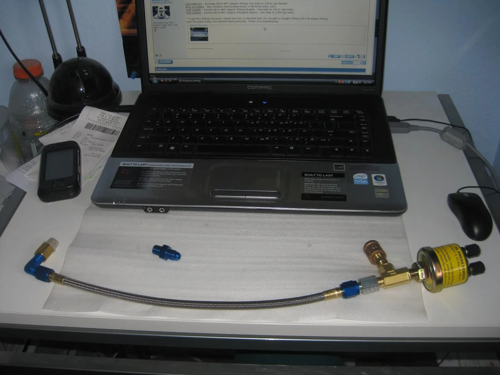

oh sorry. I thought it would show. Ill post the parts numbers. This could help anyone else who had the same issue as me.
AER-FBM2721 - Aeroquip AN to NPT adapter fitting(-4an male to 1/8 in. npt female)
NOS-15210NOS - Nos stainless steel braided hose(-4 AN femal ends, 12in)
SUM-220446 - Summit AN to NPT adapter fitting(straight(-4an male to 1/8 in. npt male)
SUM-220450 - Summit AN to NPT adapter fitting(90 degree(-4an male to 1/8in npt male)
^^I got two fittings because i wasnt sure how to blocked look. So i bought a straight fitting and a 90 degree fitting.
I got the parts today and ordered them yesterday. Thank You Summitracing.
