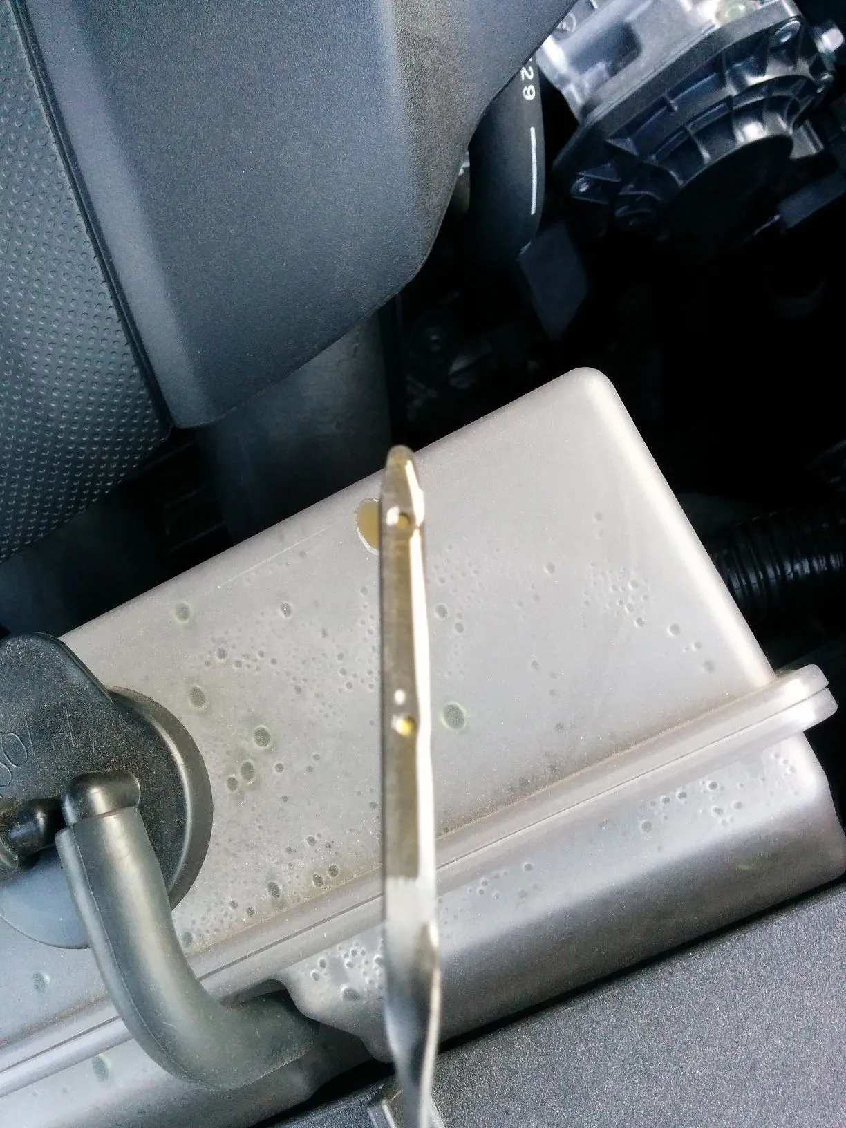

I just had my first oil change (4mo., 3400km as per Schedulle 2 here in Canada) the other day. As we're going on a long trip on Monday I thought I should make a note of the oil level so I can get an idea if the engine is burning any oil when we get back. To my surprise the level was over an 1/2 inch above the full mark. As my driveway has a bit of a slope I moved the car to the street which is fairly level, waited the recommended time, measured and got the same result. It looks to me is's so overfilled that the car level does not make much difference in the oil level measurement. I have always done my oil changes before and this is the first time I let someone change do it for me, shame on me for not checking it right away. It's common knowledge and the manual clearly states that oil overfill could cause engine damage; has anyone had this experience with their CX-5 and what could the damage be? From the odometer it looks that the car has been driven for about 50km since the oil change (+ another 15 to take to the dealer on Monday); is that enough for concern?

Perfect time for this to happen; we have mini heatwave here with temperature heading upwards of 30C. At least I tend not to race the engine at high RPM's. Here is a picture of the dip stick.

Overfilling can cause oil frothing which could lead to improper lubrication and engine failure. However, it happens if it is beyond a certain threshold, where the crankshaft can touch the oil. I don't know what is that threshold in the CX-5. If you already traveled much with this overfill it is probably fine. You probably would have some froth on the dipstick if this was the case (and you do not), but I'd go to the dealer and demand they fix it anyway.
I don't know what the threshold for over-filling a CX-5 is either. But I would be willing to bet that the Skyactiv focus on optimum mpg has the recommended crankcase oil level at a minimum to reduce fluid friction.
As much as I disapprove of over-filling, I doubt it caused any damage based on your easy-normal driving for a short distance (and lack of any evidence of problems).
