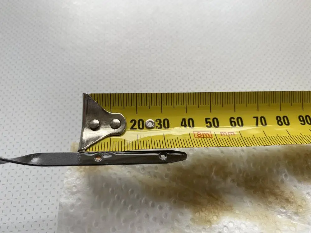

My CX-5 has recently had its first oil change from new as part of the annual Mazda service. I check my oil levels monthly and from factory it had always been at the max mark - historically I have always checked it cold in the garage and only recently learned that the manual recommends warming the engine first (not sure how much of difference this will make on the dipstick).
Anyway, after the service the next month I checked the dipstick to find out that it was quite overfilled - see image below.
Unfortunately I had driven around 1000 kms by this point and I'm worried about any long lasting damage that may have been caused. I took the car back to the Mazda garage and explained the situation and they drained the oil and refilled it. After I got home I have rechecked it and to my amazement it is still over the max mark as below.
Took it straight back to the garage and the head mechanic took a reading (engine wasn't cold this time as with the previous readings since I had driven to the garage) and although it was over the mark said that the reading was fine.
At this point I honestly don't know what to believe and am looking for a second opinion. Do I need to go back again and have some more oil drained?

In your case the first oil chang (the 1st picture) was a quart overfilled which was a mistake by the tech.
A quart overfilled may cause some damage due to the reason MyFirstMazda mentioned above. But you can’t prove anything at this point.

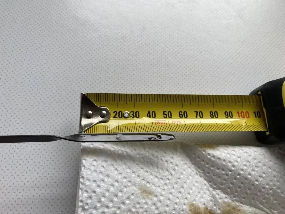

The second reading is when the engine has cooled completely (about 5 hours after use) - I could leave it overnight and recheck if that would make much of a difference.

Second picture is fine. 1/4 quart over isn't going to hurt anything. It wouldn't surprise me if it was at the full mark if you checked it cold after sitting overnight.
The only thing that I've noticed makes a difference for the oil level reading on the dipstick is the angle of the car... i.e. my driveway has a slight incline. Not much at all. The dipstick shows 1/2 qt lower on my driveway (car's nose slightly inclined) than when level in the garage. Conversely, if I check the oil where I park at work (slightly declined) dipstick shows a little higher on the dipstick.

Since I haven't taken a reading after revisiting the garage I will take it after sitting overnight and see if any difference.

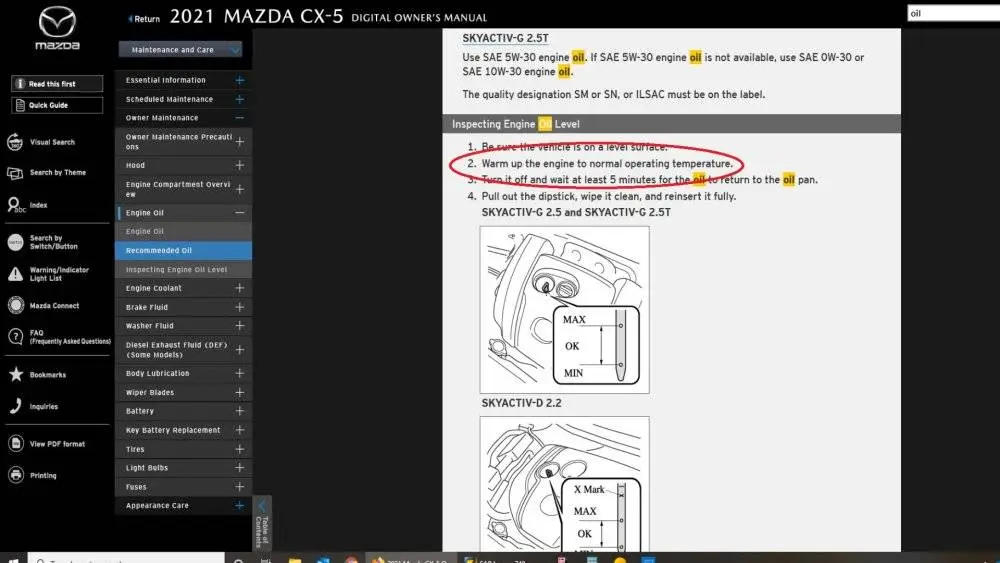

Yes, it does reference oil temperature, and I wouldn't go too high on that oil level. If it hits the crank it may foam up.
As it turns out, this isn't specific enough for some owners, because the following instruction to "wait at least 5 minutes" is too vague and can be open to interpretation, i.e. 5 hours satisfies the "at least 5 min" condition.
At the end of the day, I think the most important thing is to be consistent with the process you decide on when doing your oil changes and checking the oil level. If you're consistent with your process, it can eliminate the process as a variable if an issue arises.

I checked it again first thing this morning and it is showing the same reading as image #2. Nothing much more I can do now other than ensuring it is all on record with Mazda.
