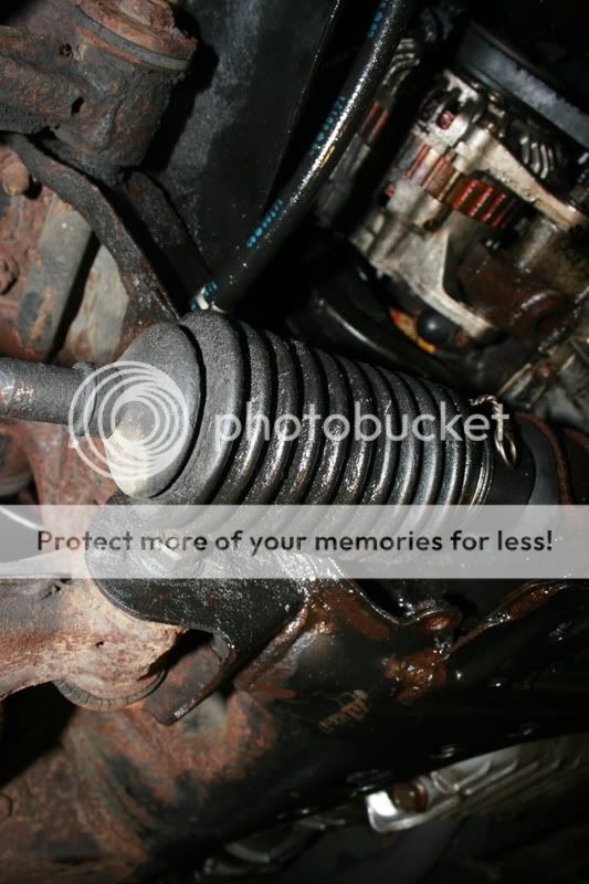

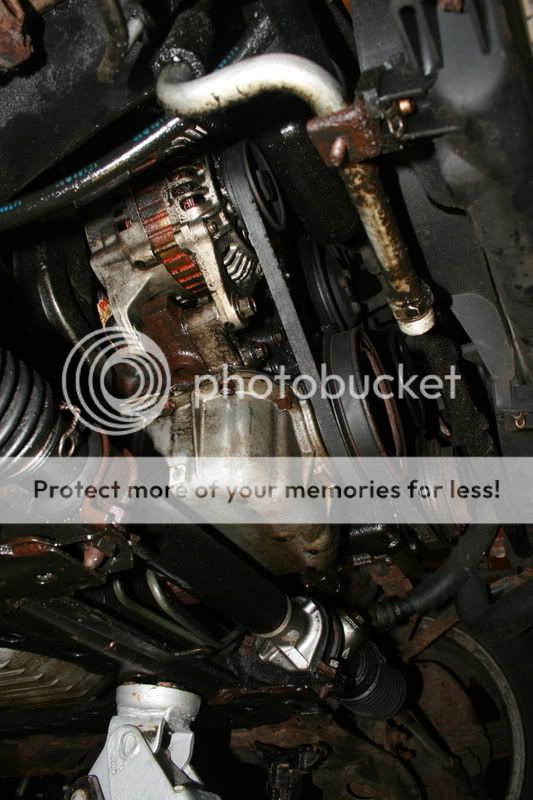

When I was changing the accessory belts in prep to head to the PA Mountain Cruise, I noticed that the engine bay is pretty soaked in gunky oil and dirt. (unamused) What's interesting is that only the front and passenger side (right side, if looking forward from inside the cabin) from the radiator to the firewall are affected. The driver's side is relatively clean, compared to the other side.
Hopefully this provides an idea of what the affected area looks like.
While on the cruise, ~500 miles round trip, 7 hours at at least 4-5k rpms to keep up with a certain silver P5.. I ended up losing 1.5 quarts of oil. (boom06) It doesn't burn any oil, I'm almost positive, but I noticed fresh oil on parts that I know I cleaned off while replacing the belts. When I took off the passenger front wheel, there was even a small puddle of oil on the inside of the rim!
