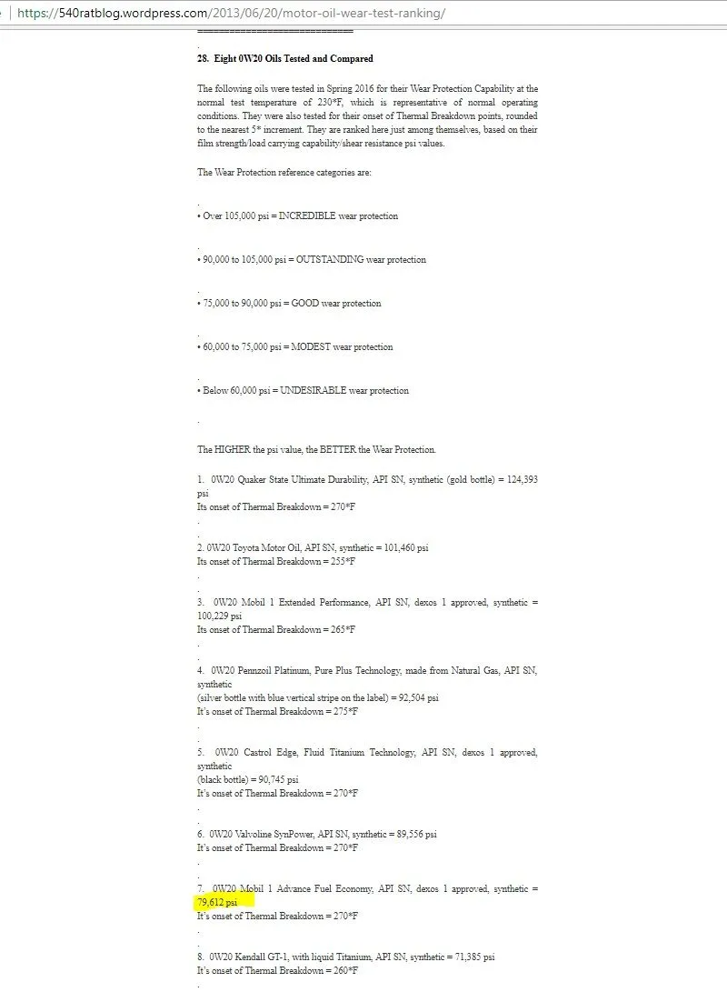

AMSoil is still better then mobil 1 garbage. castrol is not that good either.
the best is liqui moly or motul.
Just curious - why do you write Mobil 1 (AFE) and Castrol oils are garbage?
I was under the impression that these two oils fall in the category of the top five synthetic oils to use.
They are both top quality oils. Take no notice of the puerile comments.
He might be referring to the link that ColtCX-5 provided? tho Castrol doesn't look too bad compared to the Mobil 1 AFE.
