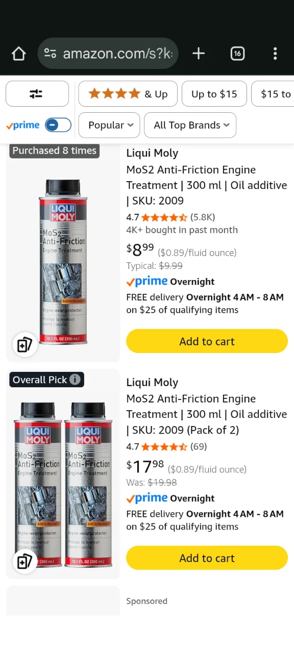

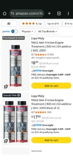

LM moly treatment is available on Amazon for about $9. Can it be cheaper elsewhere?

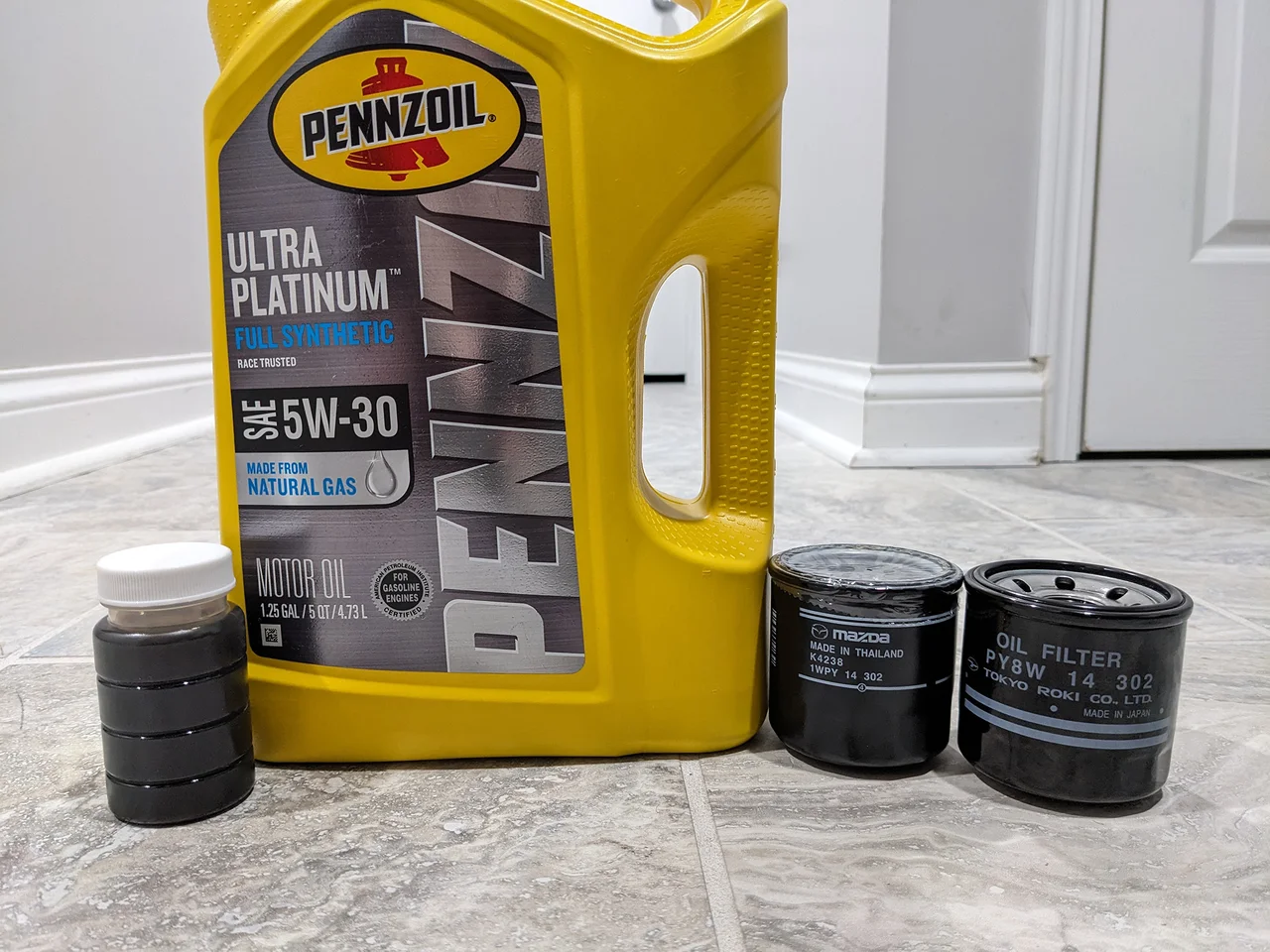

I see you're using 0W-20 which tells me non-turbo. The OEM filter would be 1WPE; 1WPY is for the Turbo. Anyway, they are the same filter media and shell. They are indeed smaller than the OEM from Hiroshima. I took a picture of mine at my first oil change:
The PE01-14-302B filter that you cite is likely the "value line" filter. I have not seen one in person.

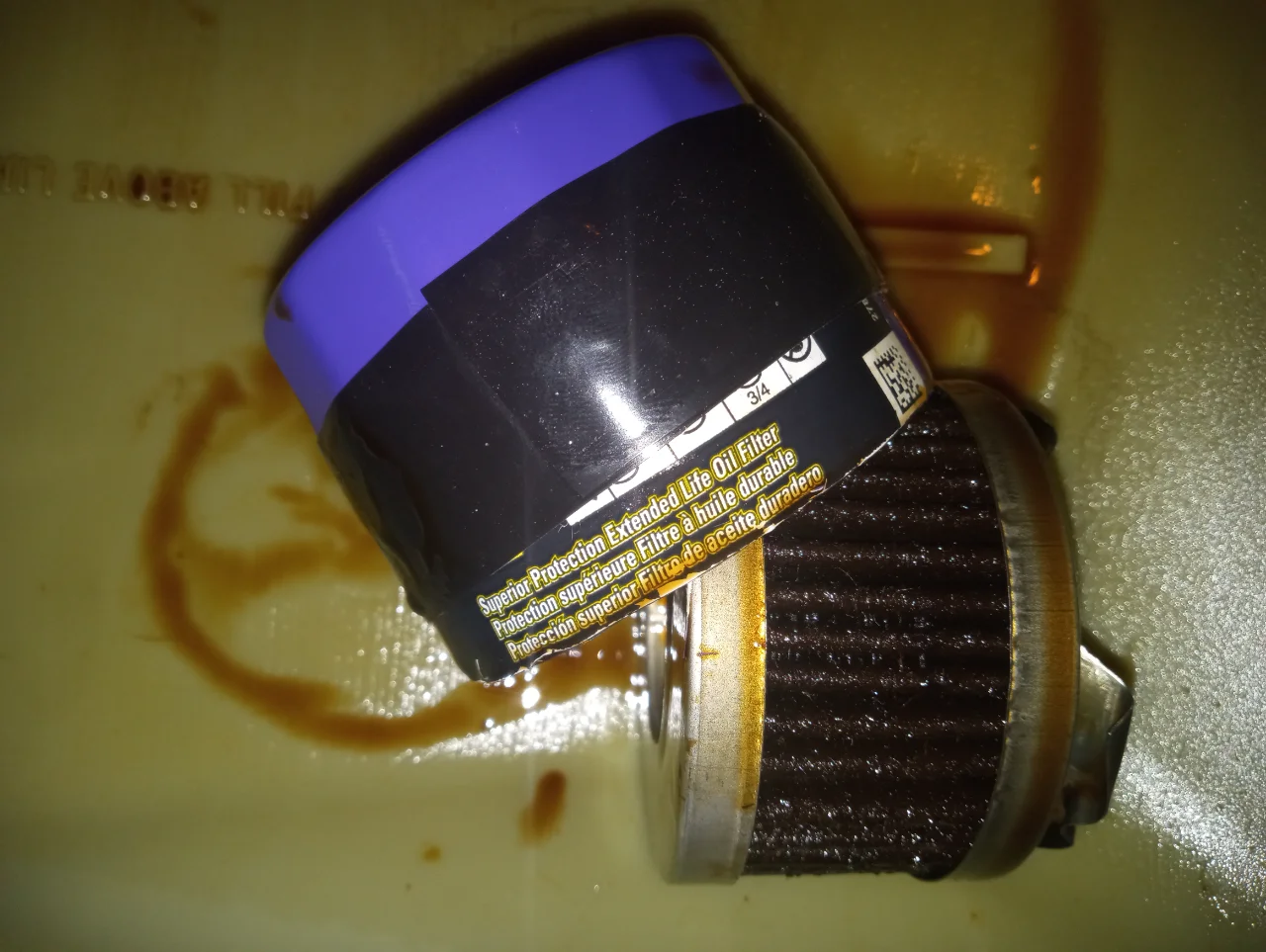

I may need an oil filter wrench after all. Trying to cut open my most recent used filter and have zero grip on the metal body. 🤦 The strap wrench that I do have is for an old Suburban and much too wide.
Edit: Added that $12 tool to my cart and thought that's almost the price of an OEM filter. Decided to try something else. I wrapped a strip of silicone self fusing tape around the metal body and got a good grip with my bare hand. I also repositioned the cutter to cut into a different point.
