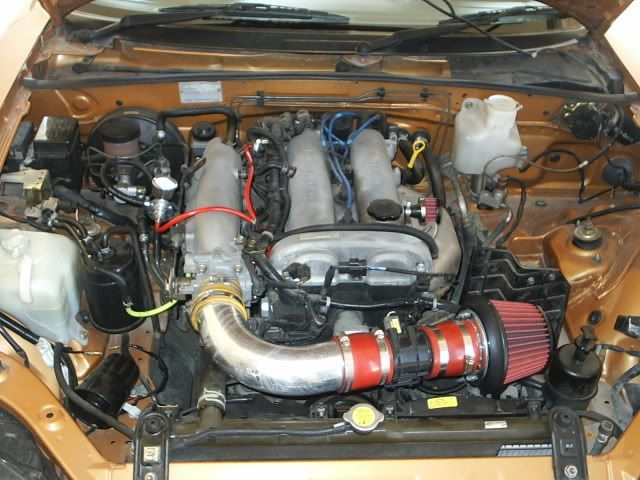

ok i searched the google for hours, i search the topic with no results and i tried to "read" the chinese diagram. a few days ago it was my birthday and a friend of mine brought me an oil catch tank
unfortunately the instructions are in chinese (and i only speak greek and badly english). so, does anyone knows where the two hoses go? i guess the one goes on the place where i have a small filter now. the other one?

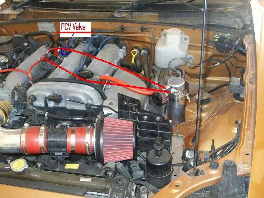

Negative Ghost Rider, here's how it should go. You need to double check which nipple on the tank is the intake side, and which is the PCV side:
no ******* way! by this way except that i'll be loosing pressure and the FPR wont work properly the oil catcher will blow the oil back (shocked)
Negative. The way it's set up now, it does absolutly nothing. Think about it, what did that little filter do? did you have oil coming from there? no. all you have now is a fancy crankcase filter.

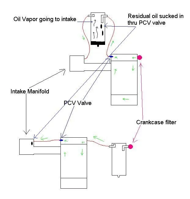

I was bored and whipped up this awesome diagram for you guys. Hope it helps shed light on the subject. The green air is the airflow created by the vacuume from the intake. Top diagram is proper install, the bottom one is your install.
Please also note that by posting how to install it, I do not support the install. On a fairly stock street car in proper working order, you do not need a catch can.

now i get it! miaturbo the place where the small filter is should connect with intake pipe. right? my intake pipe has no place to connect it. should i change the whole pipe or is there something else i could do?
if i connect the red one on pcv as you say i cant connect the other side because i'll have to disconnect the fuel pressure regulator :S
put the filter back where it was on the valve cover originaly. Then connect the 2 lines like I diagramed for you in the original picture I posted. The fuel pressure regulator is unaffected. Follow that little 3" of black hose from the PCV valve. Thats the line you need to use.
I'm glad you understand how it supose to go now :)
