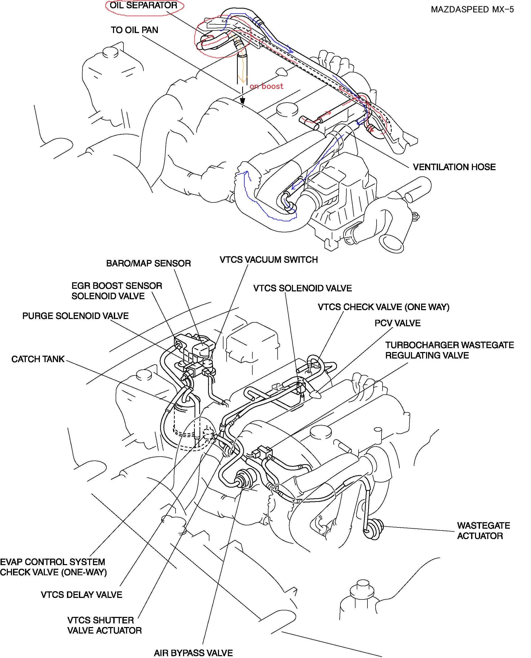

so how about posting supporting data to back up *your* claims mr certified retired mechanic which I'm saying is common misconception hence why there's more pages showing your setup method? it doesn't take someone smart to see that I've explainations and supporting data compared to you.... so how about it? I'd love to see how wrong mazda engineers, bozz speed (as well as other major big name tuners in Japan) engineers, and I are
I guess KoolDino is just imagining the oil caught in his can...
Like I said in my previous post, the way you say to mount it (and Mazda) is a bandaid fix for excessive blow by, and I acknowledged it. Since Cypress's car is N/A, he will never get oil in his can.. The way Cypress has it mounted on his car is incorrect.
Thank you for posting the diagram of the MSM. (I don't have other language packs installed on this computer so I can't read the BOZZ site, and the picture isn't clear...)

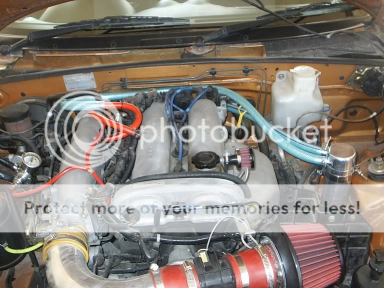

first of all thanx miaturbo and theman. i guess rac3rX is the most right :). you both have right, so for now i changed it to the way miaturbo said. the only thing left is to put a ring there where the red connects to the green pipe.
thanx again people
thanx again people
NP, glad to help.
It looks good, & you can always put some hose covers over the hoses to make them color matched if ever you want to.
