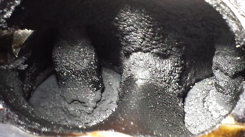

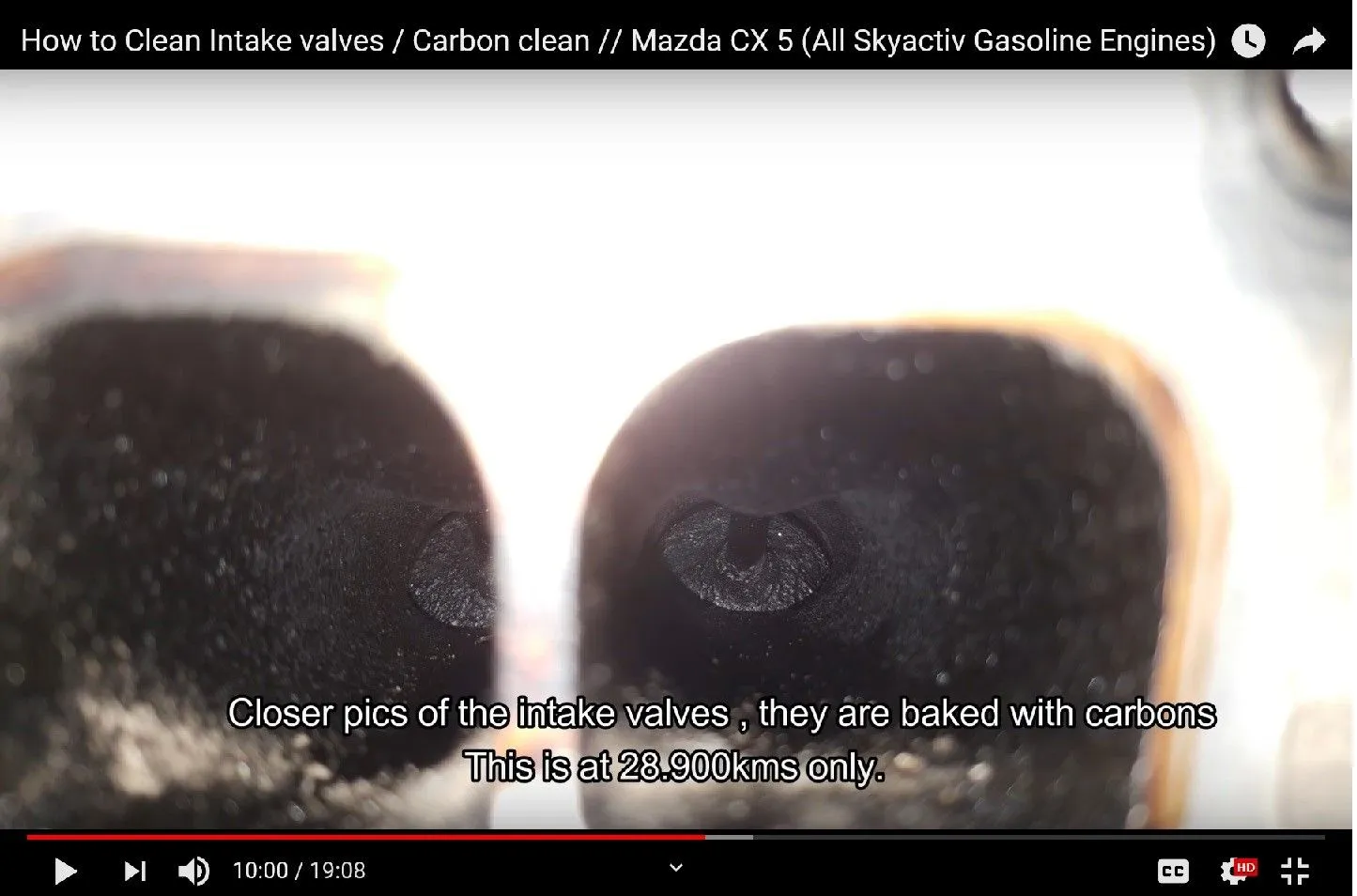

The blown-by from CX-9 in the picture is about 18ml (0.6 fl oz), but Chris's had more. 0.6 fl oz for 2K miles, no wonder intake valves look like this:
attachment.php
Considering that fuel out of the injectors is measured in mcl.. that's is alot of junk that didn't dilute your fuel charge. And some still will get through
