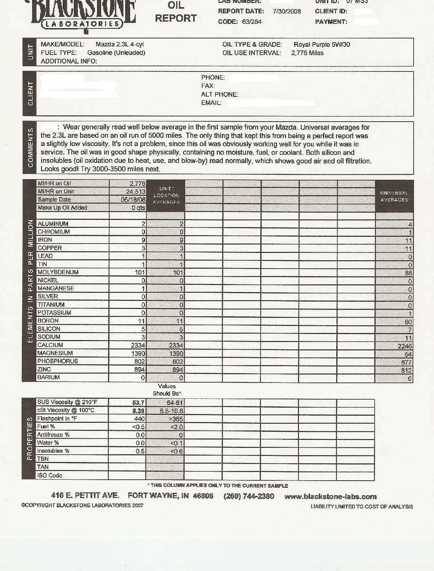

Oil Analysis on my Mazdaspeed3
"The oil was in good shape physically and free of coolant, moisture and gas."
Why are so many of you blaming the viscosity findings on gas in the oil when the report clearly states that there was none?
I have no idea what the cause is, but read the report, because it isn't gas dilution.
Try shearing of the viscosity index additives, caused by running it through the turbo charger..... Simple, and normal explanation for reduced viscosity. Also accepted by most experts as normal.
If that's the case, that car is running dangerously lean for a turbocharged car. That looks like a decent N/A fuel curve, but not for FI. Since my gas mileage in the past few weeks of ownership has been less than stellar (about 25mpg with 80% highway driving), I'm not sure how much leaner the 08.5 is actually running. Maybe this was a factory freak.
Factory freak, mis-calibration, something. Plenty of people with 8.5's posted to say their 8.5's don't run that lean.
Direct injection allows a car to run significantly leaner than port injection... but that seems a little overboard. I too look forward to more dyno results.
Not that much leaner unless you're talking about stratified DI instead of homogenous. Ours is homogenous and not gonna be a lot different than regular FI.
I wonder why the factory would put in a 5w-20 but spec 5w-30. Without a response back from the lab I just would have thought after the oil gets used it starts to thin out and resemble a 20 weight, especially with the direct injected history of fuel dilution however minor it may be.
That was a quick email off the top of his head. Definitely not conclusive. If it's not heat shearing or fuel dilution due to the turbo, why would turbo engines generally spec w/higher viscosity than the standard 20 weight?
+1
I'm beginning to lean this way as well. But I heard the dyson analysis is more accurate with regards to fuel dilution than Blackstone. Again that's just through the grapevine. I plan to do one to see if the results are indeed any different.

Here is my oil analysis I had done a few weeks ago.

Why do the comments say "..common finds in new engines such as your 4.2L."?
I was wondering about that myself. Not sure I'd trust a laboratory where they can't read. This is the second example I've seen. Wonder how often they mix up samples?
If you read the thread you will see they had made a typo. They sent me an ammended analysis report. Anyway, this is an old thread and I'm expecting my oil analysis report for the second oil change to be mailed in the next couple days.
