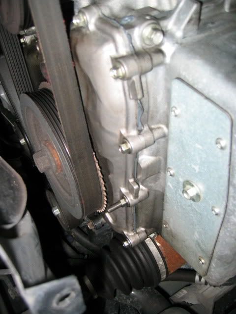

Just curious to know if the leaking oil on the turbo seals could possibly seap down to the oil pan area? Changing my oil right now to 5W-40 and I see traces of oil down by the oil pan by the tranny case and some by where the belts are. Not much at all...and my oil level was still at MAX when I started draining it.

I had a turbo replaced and found oil leaking near the return line, just above the pan. They ended up replacing the return line when the turbo was replaced as well.
Hmmm...so you attribute that to leaking oil up by the turbo seals seaping down? I find it interesting that these leaking oil stains/marks didn't appear until I witnessed the blue smoke from the exhaust. Certain bolts had oil on them, too.
Just went out and snapped some pics. Is the first one the oil return line?
Of where some oil stains are:
There was accumilated dirt and oil residue in this area, but I cleaned it up before snapping the picture:
The first one looks like the dipstick slot. Where I found it was right above the drain plug location, which it looks like from the 2nd pic. Mine was leaking from improper installation of the first replacement turbo.
Oh OK. My bad on the first pic. I just realized it is the dipstick slot (hand)
I'll keep a close eye on these areas after I've ran the 5W-40 for a while. Funny thing was that the OCC barely drained out any fluid this time. Last two times I've done it about 1/4 cup came out.
