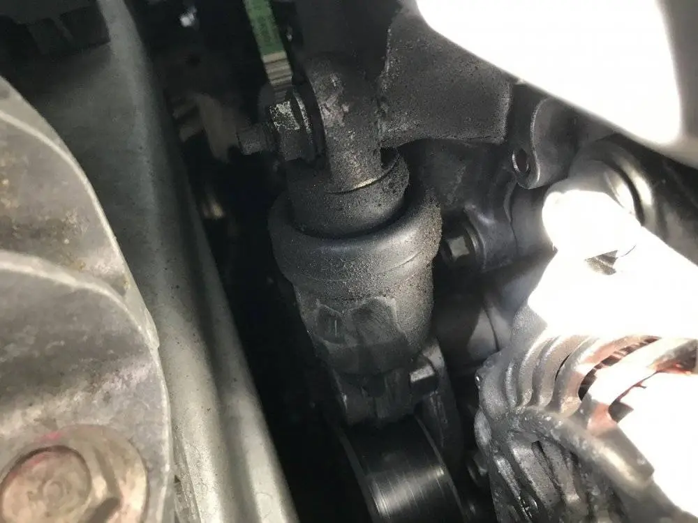

My engine sounded like yours and behaved like yours, 2 days ago.
Mine did not make as loud a noise as yours.
However, the noise showed only under mild acceleration from stationary or cruising .... much like yours.
I suspected the belt tensioner, since my dealer warned me about it many months back that it was leaking oil... I wiped it clean and have have been watching it ever since.
When the noise showed up 2 days ago, I immediately suspected the tensioner.
I checked and did see new oil stain on it.
I went to my dealer and asked the advisor to ride shotgun for a testdrive. He heard it also.
We agreed to change the tensioner and belt out of pocket.
He wasn't too sure if that would fix the noise, either.
(Mine is out of B2B, and this is not covered by Powertrain).
2 hours later, good news. Problem was fixed.
Just FYI.
Happened to my '16 Mazda6 @47k miles.

Yes, OP @dldude should absolutely check the leaky belt tensioner!
The VERY FIRST thing any reputable honest experienced mechanic should do to check an engine out is a visual inspection on the ground and up top on the lift. The VERY SECOND thing is to hook up their $3-5k scan tool and check for any dtc codes in a full system module scan, whether or not a CEL in on the dash. This entails checking for history, pending or active codes. Then, the next step is to run a live data stream and monitor computer inputs from all sensors for disparities. This includes, map, maf, O2, cam, knock,evap, crank sensors, fuel trim etc. You can find out EXACTLY how healthy or sick an engine is by doing that.
These goombas and jamokes you took your car to are a disgrace to the industry and exactly why good honest mechanics have a bad rap because they are all classified in the category of crooks by the losers who money grab above.
2014 mazda cx-5 touring FWD
It's a shame that the oil was changed, would be interesting to see the insides of the old filter for metal or have an oil analysis done on the old oil. Doesn't seem like competent , thorough diagnosis was done and is still too early to condemn the engine as being shot. Was the oil pressure ever measured with a mechanical gauge? This shouldn't be this difficult to diagnose by a good shop.
Pueblo county CO
CX-5 Sport 16.5 6M
I would second that. Getting an oil analysis done sounds like a good idea. A bad rod bearing would cause scraping and metal bits in the oil.
