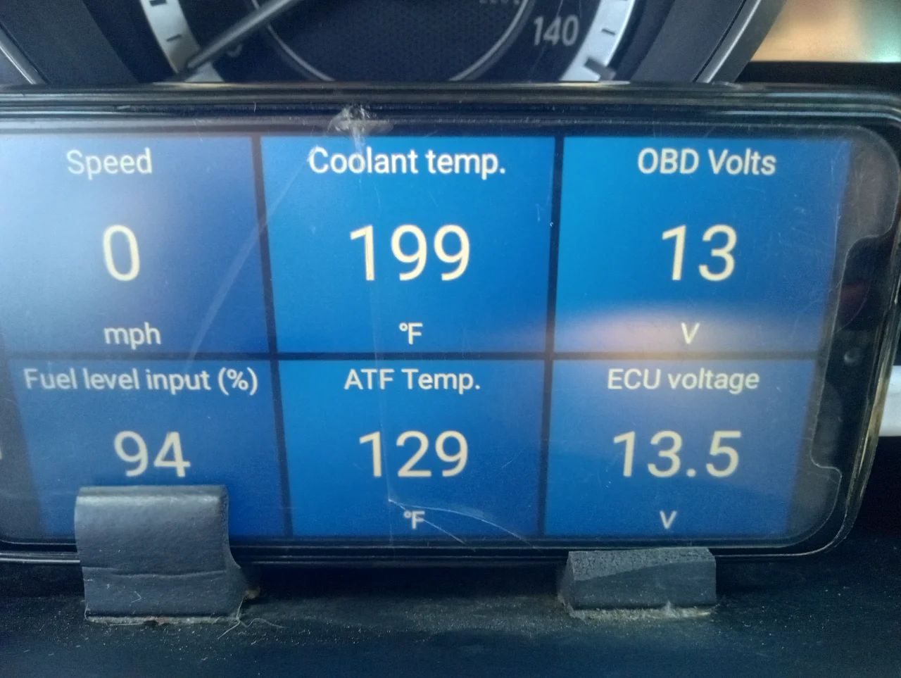

Do any of you keep your OBD2 scanner on to monitor values not shown on the car's dashboard? I have a spare Android phone that is now doing that job. Besides coolant temp (194~214), ATF temp (188~208), battery/ECU voltage (14/13), there are many more sensors to choose from the app. I understand that not all of them are available for my specific car/connector. What are some other values that are useful to monitor and log? It's a 2017 CX-3 that didn't need extra attention until this year (after 153K+ miles). Thank you!

Temps and voltage are easy to monitor, most engine parameters are best data logged then reviewed afterward until you find a set of parameters to review live.
It gets cumbersome to review live engine parameters constantly.

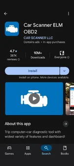

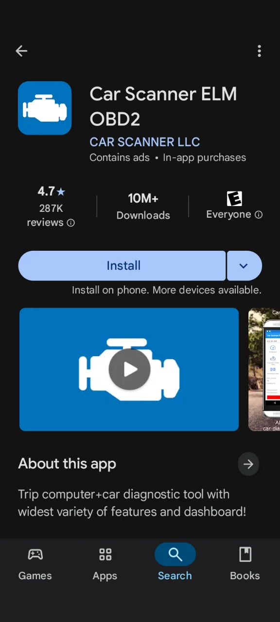

I bought a Veepak BT dongle for the BimmerLink app when I was working on my R56 in July. Now that it doesn't start any more, I use the dongle on the CX-3 with the Car Scanner Pro app. I forgot what additional features I got for $5 extra. It's nice to have 6 values displayed on one page and I can have multiple pages.
