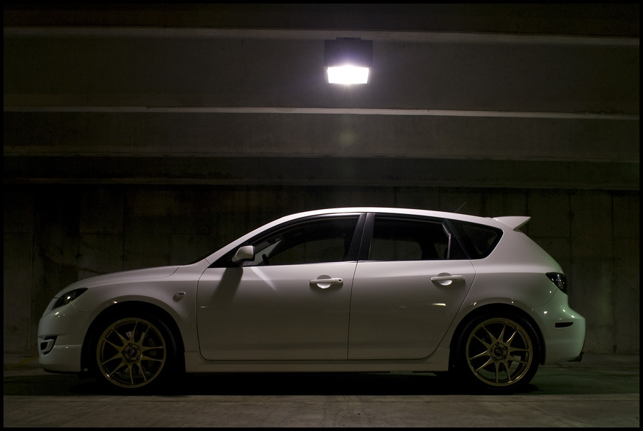

Yeah sorry they are 30 offset!!
And it was rubbing real bad but I kind of.. And I mean kid of... Rolled the fenders lol I got some more noob pics but I'll try to post some later
They fit but before the rims I got a great deal on 225/45/18 so I took em and now it looks like I need a 225/35?!?! I dunno
No *not lowered and yea your right on point with the specs
definitely need a proper fender roll either way. going with a 225/40 instead of /45 would help, but i bet you'll still rub on hard bumps. going down to a 215 series is probably your best bet.
a little beefy...
All setup for the local rally races I see, nice.
Your going to need to put a lot of work into the fender work to make it clear properly, plus more camber. Might want to hit up some of the other members who have had aggresive set ups like that (madvillian).
^^Roll, pull, and pray.^^
A 235/40 would work well. 225/40 if you really don't want problems.
Haha thanks for the help guys!! I think I'm going to try roll , pull , an pray technique haha!! I did a little rolling and I only rub on big bumps..... I'll eventually get new tires for sure I'll be posting pics soon
