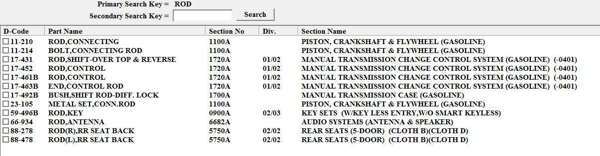

since there are no push rods, i assumed that the con rods are the only rods in the engine. ;)
Using keyword "Rod" @ Mazda EPC2
oh, yes, i'm definitely talking about PN 66-934. ;)
I'll try to find it if nobody knows.
