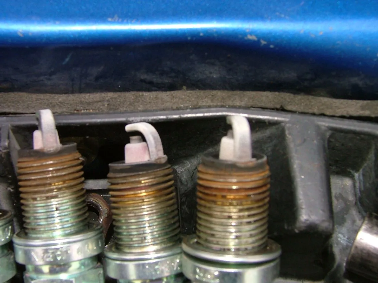

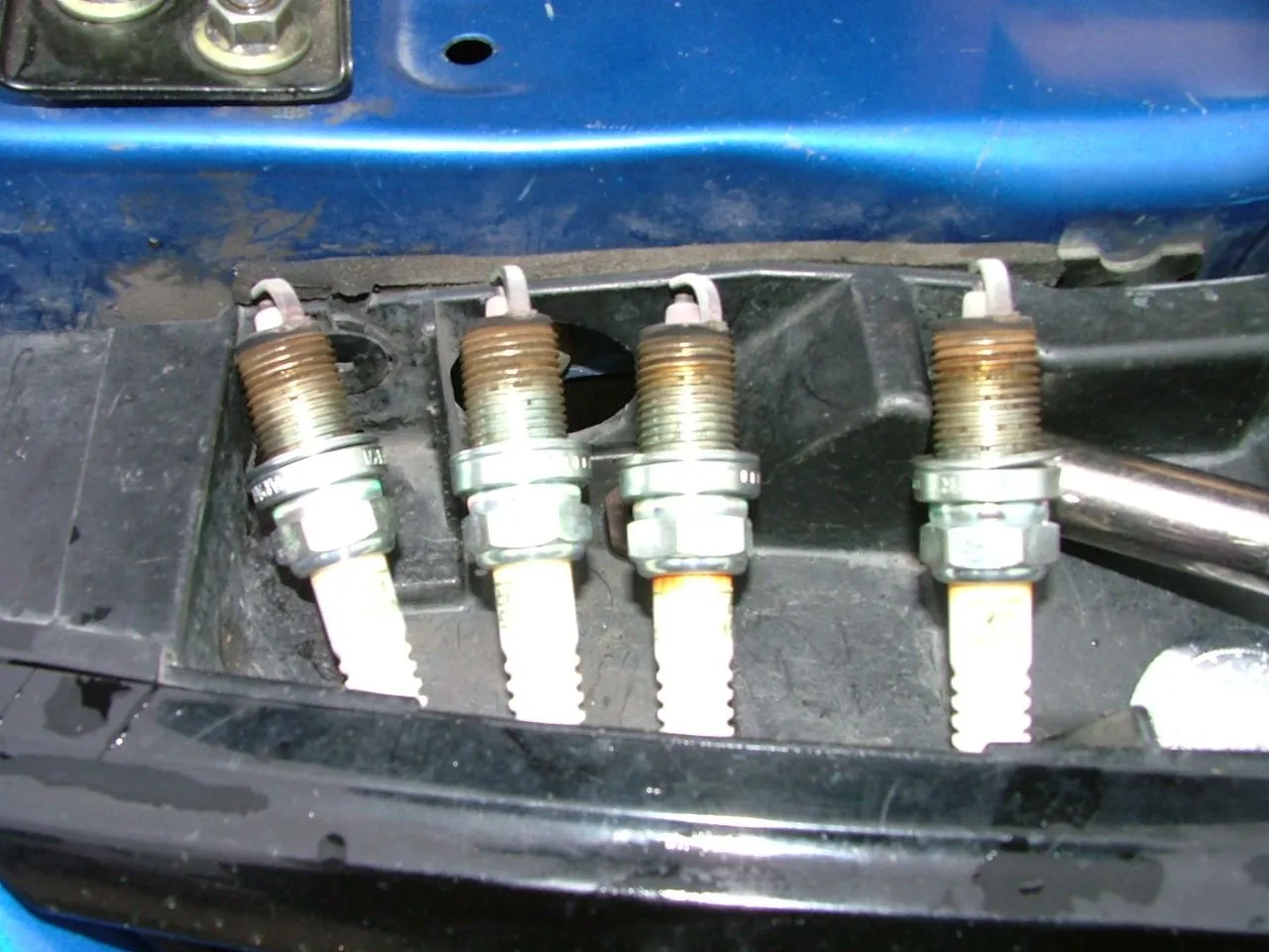

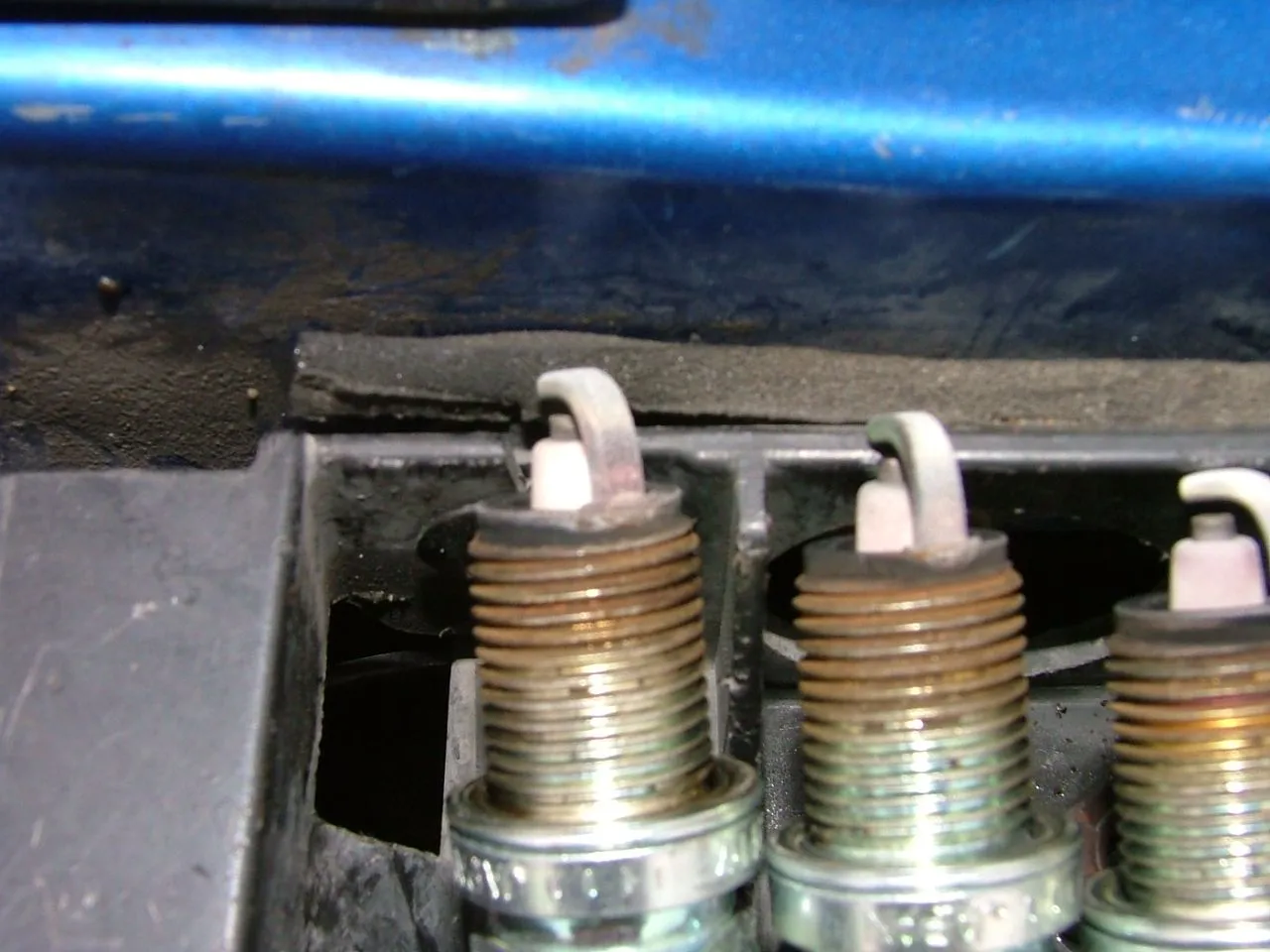

BTW, I have new pictures of my old plugs. HOT is all I have to say:
(nervous)
(nervous)
OMG!!!! THATS RUNNING LEAN! Where those your current plugs?
When you pulled off those?
holy shizzit those are hott!!! What kind of EGT and AFR's were you running? Are those your extended reach plugs or just BK series plugs or what??

Someone want to explain to me, how you can tell your running lean or Hot by looking at the plugs. I know you have o check for whiteness, but not sure where it is suppose to get to.
Simple, they should not show whiteness like that. Only near the tip.
Blue arrow (should not go past over this mark)
green arrow (shows how far temps where reaching.
This shows; or the plug is too hot for the application, or the car is leaning out.
I dont really understand how you can tell to go to a colder or hotter plug. Where should the green arrow be if you have the correct heat range plug?

a colder or hotter plug is really about how much contact there is between the ceramic and the threads. The more contact there is between the ceramic and the threaded part of the plug (the sleeve or what not) the "colder" the plug is because it'll stay cooler by conducting more heat out to the block. The reverse obviously for a hotter plug.
I think he is saying that the green arrow should be where the blue arrow is. I've never had plugs run hot in the least (typically am carbon fouling actually... too rich and the like) but my timing and fuel and so forth are still a bit "out".
Yeah, blue arrow shows where it should be.
Anyway, I prefer to see a black plug when I pull them, So, Im going back to 8grade plugs and smaller gap = R5672A-7 -> too bad it send some noise to the radio.
