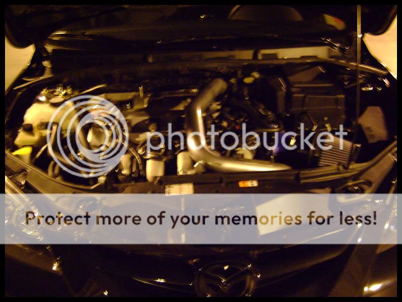

right now im running:

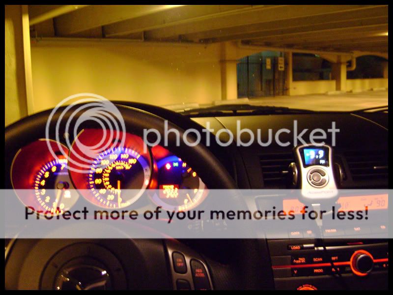

cobb accessport
cp-e downpipe and catback
cp-e fmic
cobb sri
forge bpv
mrlilguy cdfp
rpmc turbo inlet
bc coilovers
cobb rear sway bar

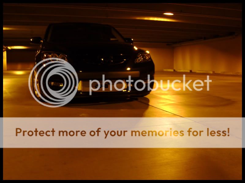

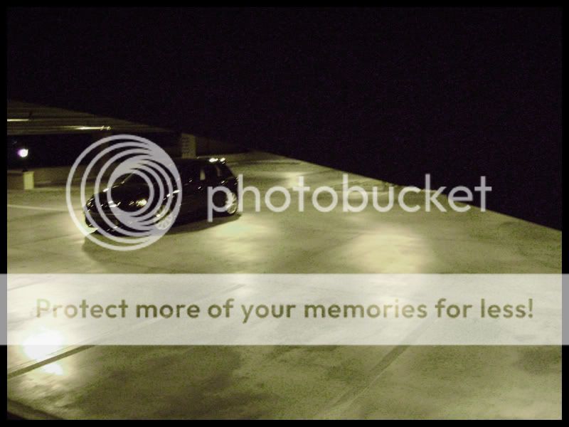

anyway, heres some pictures!

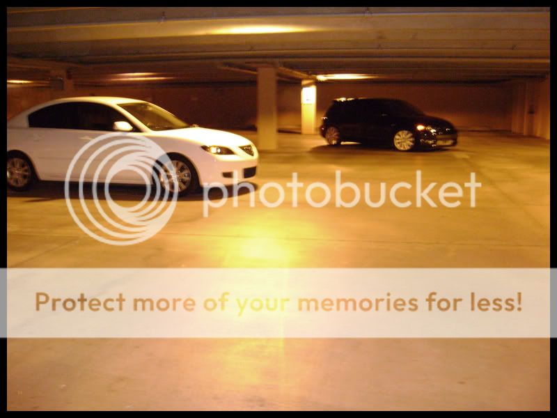

the wife's car on some eibach pro-kits...
Really dont like when people take off the front grill in front of the intercooler, just my preference.
Everything else looks great though! extremely tasty mods!

Nice..and welcome. How do you like your RPMC turbo inlet? Any noticable differences?
it definitely spools faster, but it isn't one of those "bang for the buck mods." since i've basically already cleared up most of the major restrictions in this car i figured what the hell.

To each their own, I disagree and LOVE the front grill removal with a fmic. About to get my fmic btw and wondering how easily your fins get bent? I realize that over a few years I might need to swap out if it gets too bad but I really love the look
the fins do bend pretty easy, but if you think about it that grill isn't going to protect it from anything, not water, not rocks, not dirt, not weeds. i think it looks sick without it, so ill probably leave it that way for a while. but yeah, after a few years i would imagine that they would be pretty bad. what kind of fmic are you going to get?

That grill is part of the bumper though right? If I cut it out, I can't just go to mazda, buy a new grill, and screw it down can I?
I have a top mount and I have bent fins so, really really easy i think Some member mentioned tweezers when I first joined and I had no idea what he was referring to. I do now. The car looks very nice!
Best way to fix bent fins on a FMIC is to use a fin straightening comb tool. I keep one in my work tools since I end up messing with chilled water climate coils fairly often. They're only about $10 for a decent one and do a great job. Most HVAC supply houses/tool stores should have them in stock. Certainly is a cheaper alternative than replacing an IC for bent fins.

well the grille is just part of the entire bumper, which comes off surprisingly easy. it would be impossible to take the honeycomb out with the bumper on the car, so when you install your fmic and the bumpers on the ground it comes right out, and you can always put it back. ill take some more pictures tomorrow if i get a chance, those are pretty bad.
