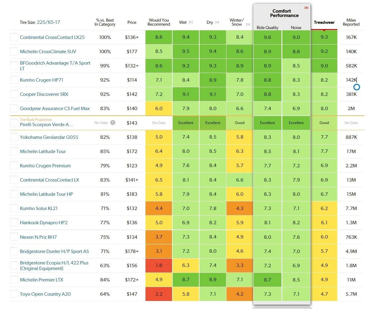

What is the best tire choice for ride comfort and quietness? I only drive 5-6,000 miles a year.
Here's Tire Ratings Charts from Tire Rack for Crossover/SUV touring all-season 225/65R17 tires; the rating for 225/56R19 should be similar. Check “Comfortable Performance” category rating which is what you want:
