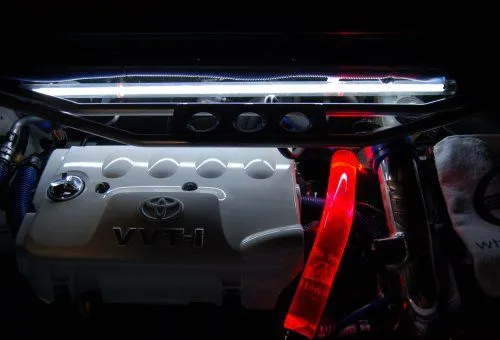

you should get these (J/K): www.killerglass.com
