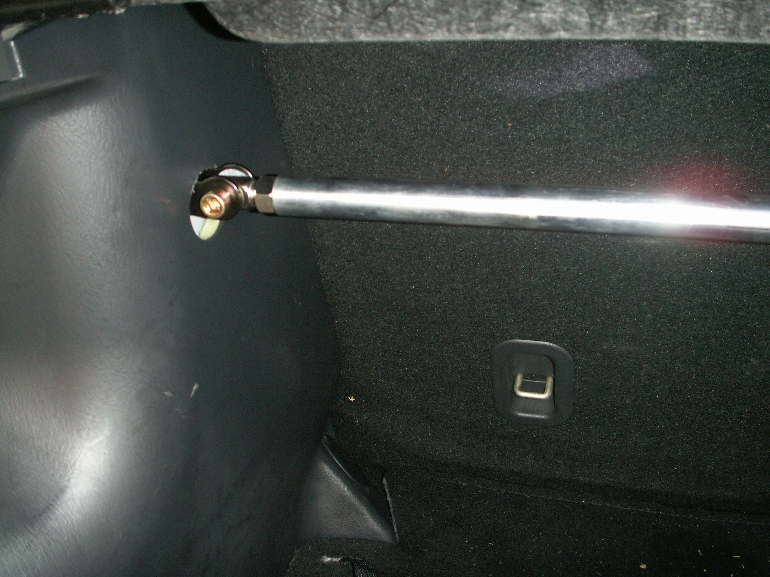

Just a note to add to this. Went to ebay found the mx6 bars but there are anodized red & blue megan strut bars for the mx6s also. The prices are higher for those of course - 80-85.00 plus shipping. I have a question about final install. Can you get to the bolts to remove bar from mounts without removing the panels in case you need to haul something & the bar is in the way? Couldn't quite tell from the finished picture.......
It looks to me as if you can. I copied the pic out and zoomed it until it was too blurry to see anything but, it appears that the brackets just stick out past the panel exposing the bolts for the bar. As soon as I get some conformation I might be shopping E-bay...........
Yes you can...Here's a close up of the bar.

I did this install last weekend after receiving bar. Only thing I did different was not cutting the seat belt part but just bending the lip up with big crescent wrench then after bolting back on used hammer to knock edge back down close to top of bar mount. Fit great with no cutting.
Did you cut the plastic panels to get them to fit or what?
*Edit* - Oops, nevermind, saw the pic, very clean, great write up.
