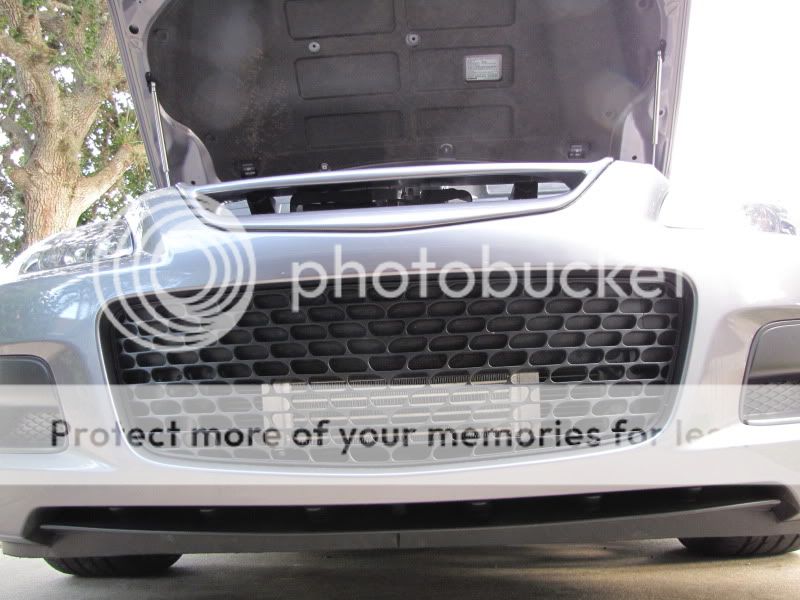

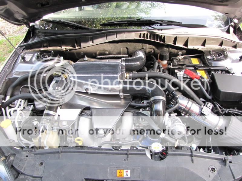

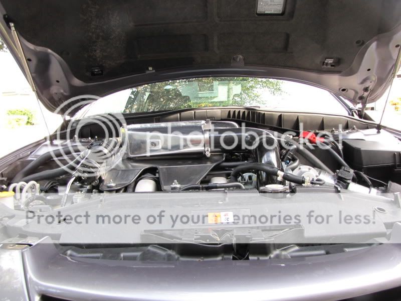

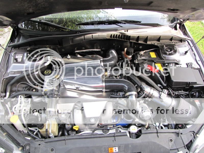

After a longer than anticipated wait, I've found the time to install
my new L2A FMIC from Turbine Tech...
Front Heat Exchanger:
Engine Compartment:
Total install time is about 5 hours, taking my time, trying things
out...typical gear head stuff.
The install was not without mishap, as there were a few
'modifications' to be made by the installer. I'm still working
the air out, as I have to add 1-2 ounces of water daily, but
first driving impressions are:
-Quicker turbo spool
-More responsive throttle
-Car 'feels' a little quicker
I haven't logged any numbers yet...
I'm in the midst of aquiring a Dashhawk to get
some numbers. Planning on a pull fan behind the
front heat exchanger to minimize heat soak as well.
When I get some numbers, I will post them.

Looks great. Did you remove the ducting from your hood as well?
Yeah the ducting is gone. It actually dropped the IAT a little
as well. More cool air getting under the hood and to the SRI.
When I first got this thing I figured it was pretty f*&%ing heavy.
After all is said and done, yes there is added weight, but after removing
the ducting, and the old TMIC, and cover...I've added about 15-17 lbs.
What hasn't been removed is any structural integrity of the front end.
Absolutely NO cutting, hacking, re-arranging behind the bumper. I
consider this a fair trade off.

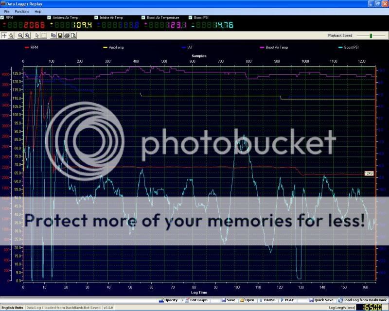

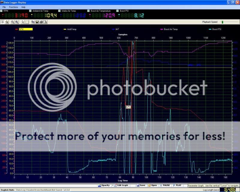

So.....I've got a Dash Hawk now. What a fun toy!
I've decided to do a couple of logs on the way to dinner,
to see just how the Intercooler performs. The first log is
getting on to the highway, from a stop, and a cruise at
55 mph. I wanted to see how the IC worked with a solid
wind blowing through it.
The next log is traveling at 45 mph, stop at a red light,
then take off and accelerate to 50mph, then, you guessed
it, another traffic light.
Seems to be doing it's job fairly well. I think a temperature
activated fan on the lower heat exchanger is going to be the
next step.
I'm going to do more logging, of course, but this is a good idea
of the Intercooler's capabilities.
