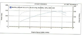

The only thing on the car during the base run was a SP2. I have the charts on disk and they just add the runs to the disk as I go back. Hope the charts come up.

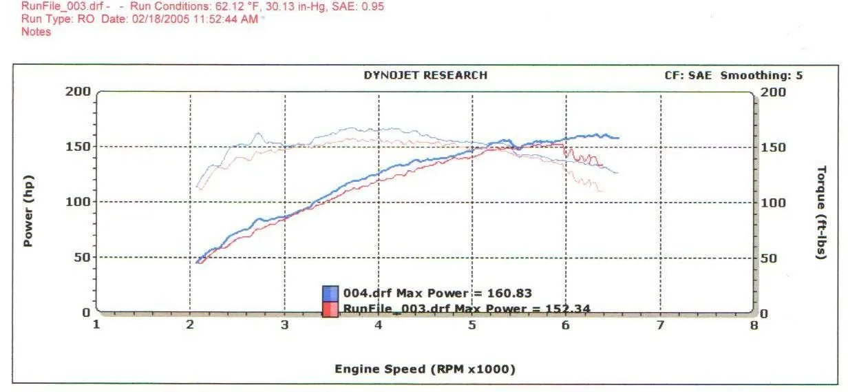

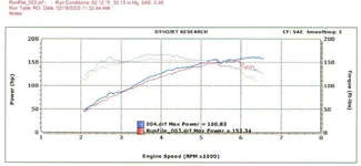

Well here are the results from today. Gained 8hp and 9tq.

only gained 8hp, 9tq? that's kinda low, but there are many factors involve too. I will go get a dyno during summer, since I still have my steelies on right now
Actually I think he said that he is stock except for the exhaust and I'm pretty sure that was at stock boost. So yeah, those numbers are actually pretty good.
