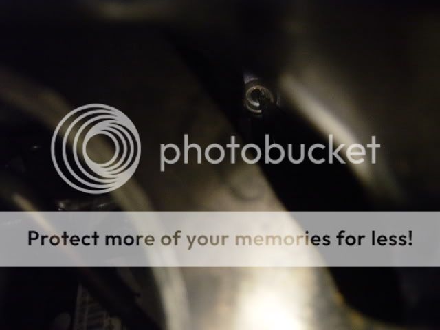

The biggest issue is getting through the firewall. After looking around from the inside, I decided to go through the grommet that the hood release cable goes through. Since it's just a sensor wire and and not vacuum hose, the grommet is big enough. Here's the view from inside near the clutch pedal mount:

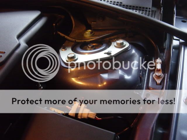

Here's the view from the engine bay, in behind the driver's side shock tower:
1. Space is very tight inside where the grommet is. So, to get better access to the grommet, I freed up both ends of the hood release cable. It's pretty easy to see how to do this if you just look at how they're attached. The end attached to the hood latch just pops right out, but then you have to manuever it around to get it free. There also two clips attaching it to the engine bay near the top of the radiator. You can just pop it out of those clips. Inside, it's just a matter of pulling the hood release handle and rotating the cable end up to where it will slide out. With the cable loose, you can now pull it into the cabin about 1 foot further than it is when installed. You can now pull the grommet out of the firewall and into the cabin, too. I think I ended up pushing it in from the engine side with big screwdriver (careful not to tear it).
2. Next I took the small blue coupling that attaches the sensor wire to the boost gauge and feed it through the firewall into the cabin. I attached it to a coat hanger since it's kind of far back and hard to reach.
3. The next part takes a little patience since the grommet opening is kind of tight. To get the coupling through, I took a philips head screw driver and stretched out the cabin-facing end, and then fed the blue coupling through the engine bay-facing end with a coat-hanger. I bent the coat-hanger around the front of the coupling so that the coat-hanger was the first thing pushing through the grommet. I still had to manuevered it through the accordian section of the grommet until I could grab it and pull it through. I then pulled the rest of the sensor wire through and left about 3 feet in engine bay, reinstalled the grommet in the firewall, and reconnected the hood release cable ends.

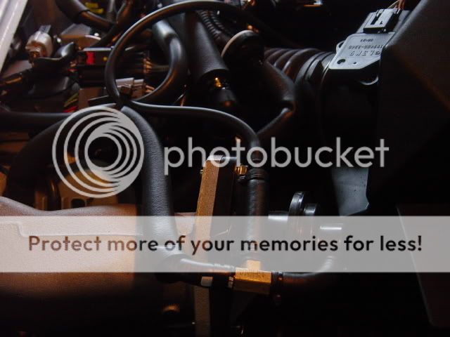

1. I removed the TMIC cover to get easy access to the 1/4" BOV hose and attached it to one side of a 1/4" brass tee I got from NAPA. I then took two 4-5 inch sections of 1/4" vacuum hose and attached them to the tee. I attached one of the sections to the BOV and the other to a 1/4" to 1/8" reducer (also from NAPA). I then attached the reducer to the vacuum hose that goes to the sensor. Everything was secured with tiny zip ties.
Here's the end result:

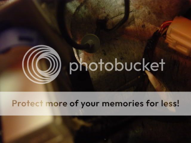

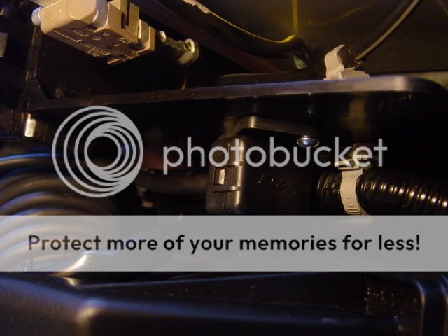

2. Next I opened up the battery box and pulled out the grey clip that secures one of the battery wires inside to the front of the box. I then attached the sensor unit to the outside of the battery with small bolt and nut.
3. Then I coupled the sensor wire that comes out of the unit to the section that goes through the fire wall and secured the coupling to the body near the back end of the fuse box.

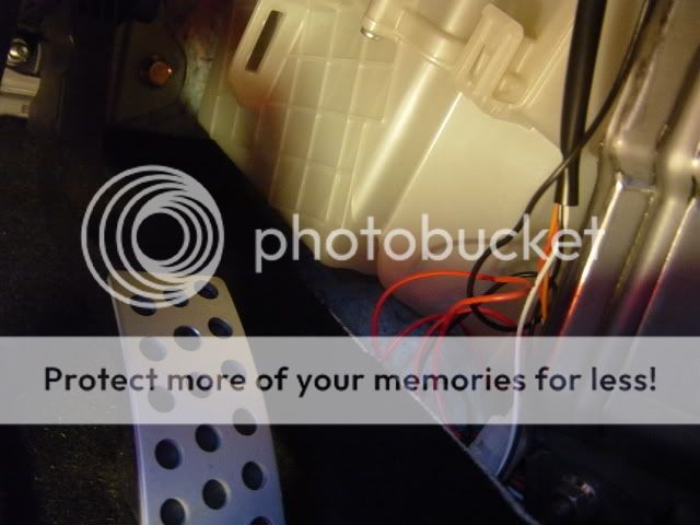

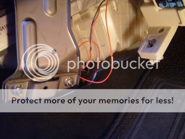

1. I removed the lefthand/righthand panels on the center console to allow me to run the power and illumination wires over to the inside fuse box under the glove compartment.
Lefthand panel removed:
Righthand panel removed:
2. The wires weren't long enough to run to the fuse box, so I attached about 3 feet of wire to each and attached them to fused lines using "Add-a-Circuits" from Autozone. We need 3 of the "mini" fuse versions, at $5-$6 each.
I used the brake light fuse for the red power wire, the cigarette lighter fuse for the orange "ignition-on" wire, and the "illumination" fuse for the white illumination wire. I used the 3 amp fuses for each since they draw a lot less than that. Ignore the color of the wires going to the fuse box since I used the same color wire for all the extensions.

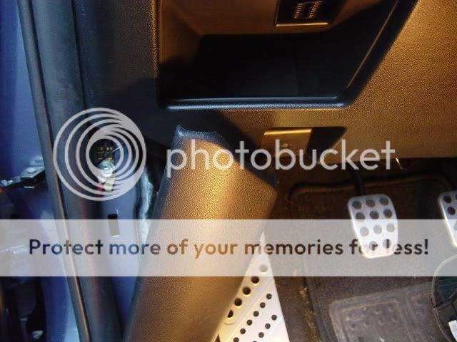

3. Next I removed the plastic panel at the front of the driver's door and attached the black ground wire to the ground point there with a U-spade:
