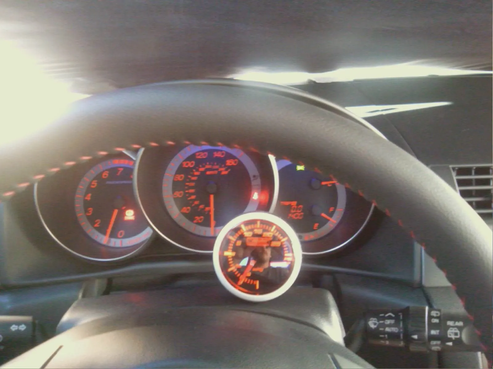

With many thanks to AG DesignWorks and Desperado-C, I thought I would post a few pictures of my Prosport BG installation. Apologies for the quality of the shots. I basically used all of the tips from the long posting earlier in this thread. I did a few things a bit differently:
- I made a couple of wiring harnesses for the sections of wire from the engine and from the drivers side across to the fuse box. I did this to keep it clean and make sure I didnt miss anything.
- The engine-to-cockpit harness was about 5 feet long using 22 gauge green, black and red wires. I split the black ground wire off from the others about half way so that it would be able to run to the ground under the drivers side left kick panel.
- The drivers side to fusebox bundle was also about 5 feet long using orange, red and white 22 gauge wire.
- I also bundled the wires coming off the gauge unit with electical tape to keep that section running behind the steering column clean.
- I mounted the unit using a modified version of the mounting "cup" from Prosport. I did not want the gauge up high enough to block anything. So I basically wanted to use the cup but mount it almost flush with the steering column panel. So I very carefully measured exactly where I wanted it (using tape on the panel) and then cut a small 1" x 1/2" hole approx 1 1/2" back on the panel behind the steering wheel for the "feet" to go through. I also cut a small hole behind that rectangle for the wires. I then cut all but about 1/2" off the feet of the mounting cup and drilled a small hole through the portion of the both feet remaining. The trick is that the hole is drilled so that it's very close to being flush with the bottom of the panel when the feet are put through the larger rectangular hole. I put the feet through the hole in the panel and used a 2" cotter pin through the hole I drilled in the feet to secure the unit. The result is that it's rock-solid and the mount is completely invisible. It does not block anything on the other gauges.
I should mention that I'm still dealing with a glitch of some kind related to the automatic headlights. The unit's lighting works perfectly when the headlights are operated manually. But there is something in the interaction with the automatic headlights that confuses the unit and it often stays "white" instead of going "amber" when the headlights go on automatically at night. Not a huge deal though...
