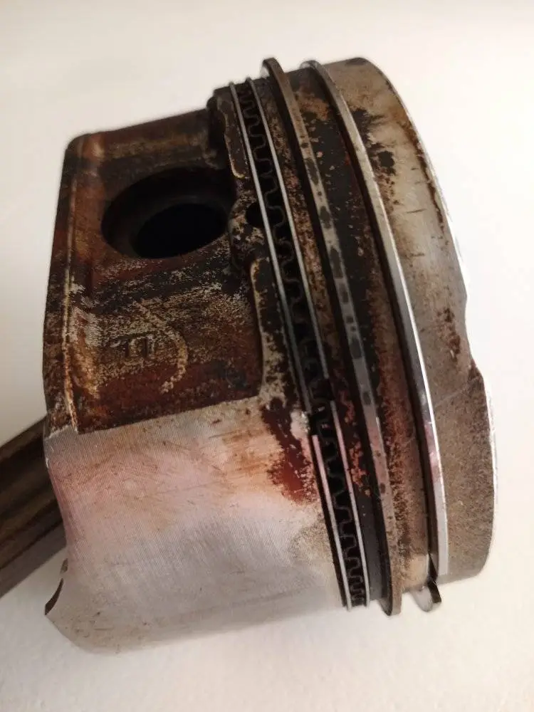

It's not your valve stem seals.
It's your piston oil rings.

Our FS engine has a specific problem with seized oil rings.
I may have the only Protege5 that doesn't burn oil.
There's a test you can do to find out if it's your rings or seals.
It's in the links.

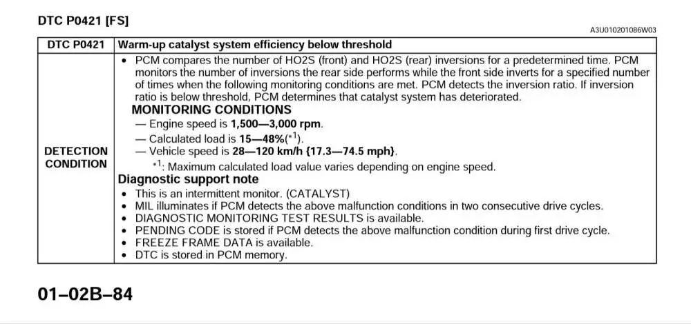

... And now the code I’m getting is the p0421 (warmup catalyst efficiency below threshold bank 1).
That's your pre-cat. It's cooked.
You can do the non-fouler trick to clear that code.
Everyone with a header does it because headers don't have pre-cats.

It's an intermittent monitor and it's quite possible to get it to the smog shop before it registers a pending code.
He could drive it to the smog shop at 15 mph to make sure he doesn't register the code. Lol
So I did the cold engine test to see whether there was oil on top of piston rings and frankly I couldn’t get a great idea because it was pretty dark and carbony down there but I don’t think it seemed wet - maybe a little moist but that made sense to me with the carbon.
So I’m thinking my next step should be trying the liquimoly plus changing the oil to 10w30? The spark plugs looked fouled too, should I wait until after I flush engine and change oil or just change the plugs right away?
