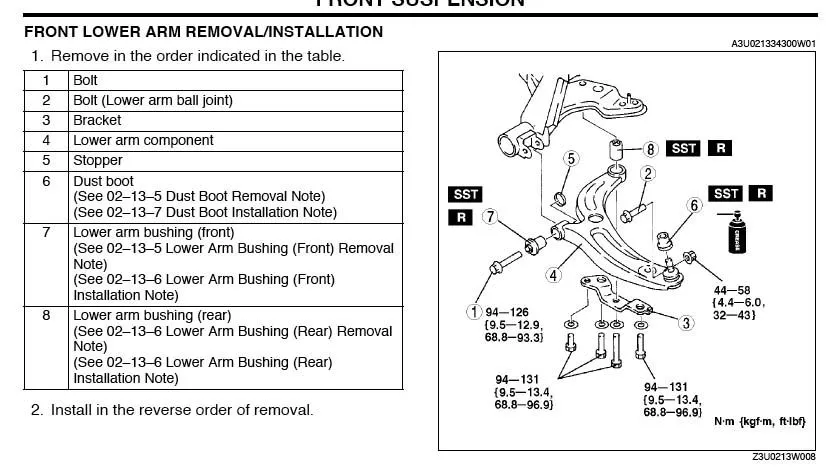

Okay I need to remove the front control arm and I am not sure how what tools do I need?
is it near the ball joint?
please explain in detail thanks :)
Here is what the service manual has to say about removing the lower front arm. First you need to remove the wheel. Then remove the two bolts holding the arm to the frame and the bolt that hold the ball joint to the wheel hub.
I would have to go check for the size sockets you will need but I would at least recommend a 1/2 in breaking, those bolts are not going to want to come off.

I did this a while ago when I bent mine at the track. It's not too hard at all. The guide above is basically all you need. pneumatic tools aren't necessary but definitely make the job easier since the hub nut is a pain to remove.

Thanks guys, I'm going to remove mines tomorow, I'm actually parting out that Is why I need it off my car, I will try using guide, I hope it is easy lol
