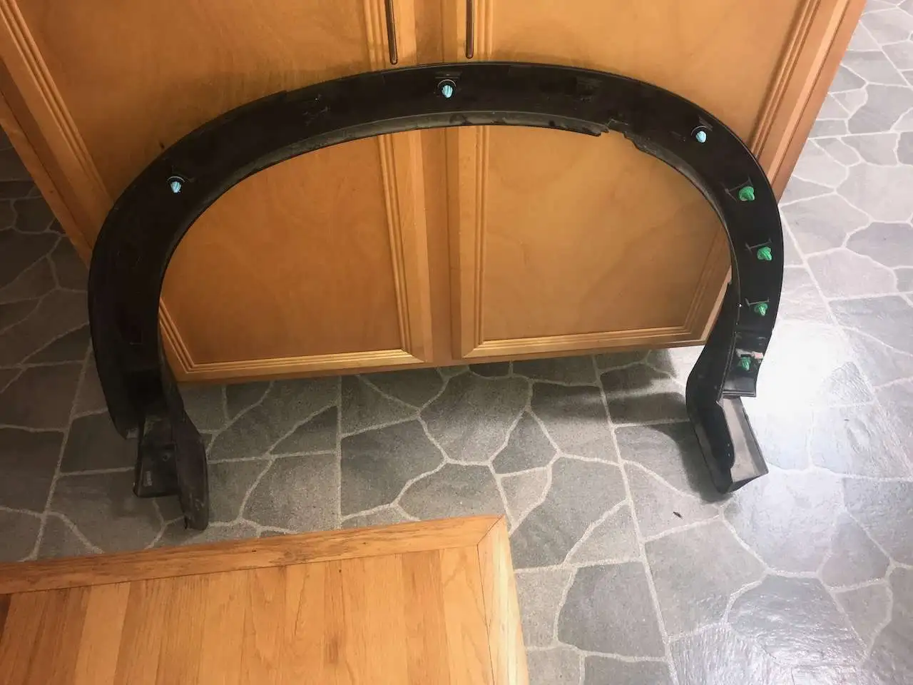

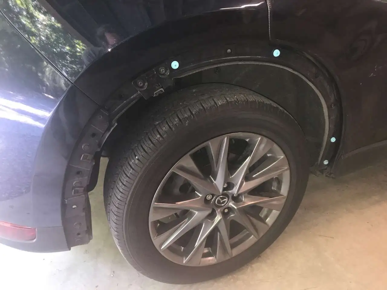

Someone side-swiped and dashed my 2020 CX-5 Signature in a parking lot a week ago and I discovered that the Right Rear black wheel trim arch was damaged (in addition to the door panel).
Three of the mounts on the front of the arch that hold the clips that hold the arch to the body panel were sheared off, taking the clips with them. I'm pretty sure I'll need to replace the arch itself, if only to get one that has the mounts attached so I can put clips in.
The arch part number stamped on the arch is KB5W 51W51 which has been superseded by part KB7W-51-W50F or KB7W51W50F8N. Assuming they are all basically the same part, it is easily available.
What I can't find is the part number for the clips that hold the arch to the body.
There are two different color clips that mount to the arch: the first four starting at the rear and moving towards the center are green. The next five continuing to the front are blue. I don't know what color the last three on the front of the arch are as the clips and their mounts were sheared off.
Is there a difference between the blue and green clips? What are the part numbers for each color? What color clips are the first three on the front of the arch?

If the clips have different color, they should have different part number. You can compare the other side to find out the color of the 3 missing clips. I’d just take the trim to a Mazda dealer and figure out the part number of these missing clips by the parts guy.

Perhaps I can see the Left Rear clip colors without taking off the trim as I would prefer to not have to take off the LR side trim. Also, I would like to know my total cost of purchase before going to the dealer.

Those clips should be cheap, $1~$3 each at most even from OEM. Comparing to the trim itself, they’re too cheap to waste your time trying to find any other alternatives IMO.

There’s no other places than a car dealer to find the most accurate part number. You just ask the parts guy to figure out the part numbers for the clips. You don’t have to buy trim and clips at your local Mazda dealer if its price is unreasonable.

Following the advice given above, I purchased the wheel arch and the one missing blue clip (round base Part Number KB8A-51-W24A) from my local Mazda dealer. It was only a few dollars more than purchasing one from an online Mazda dealership once shipping was included.
To my suprise, the wheel arch came with all the necessary green and blue clips necessary for mounting. So now I have many extras for which if I'm lucky I'll never need.
