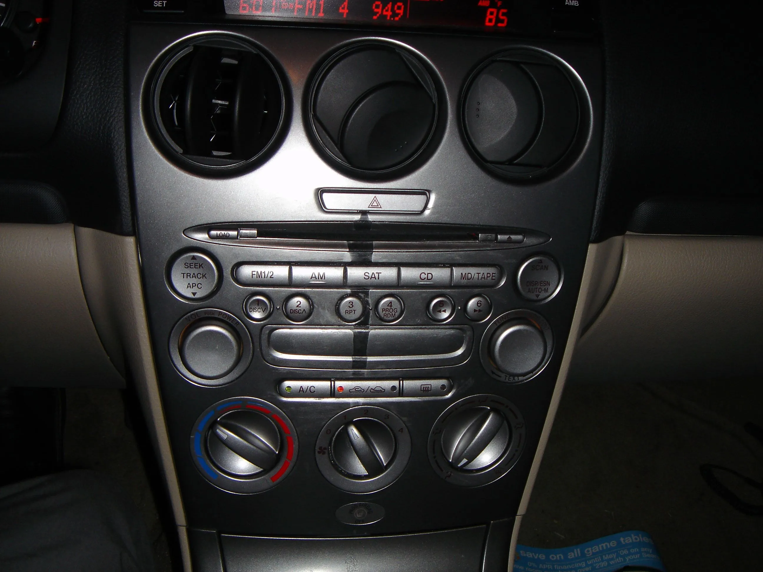

My cluster is messed up need options to fix. Cheap, fast and easy please. Went to mazda and they qouted me $560.00
Whats spilt on it , I would suggest that you remove the surround and clean it well then sand it down and paint it , Yu will have to use a plastic primer first then a regular primer and finally the paint .
Get the metra dash kit for $150 online and grab a decent head unit for the car. Shouldn't be more then $350 total depending on the radio.
I don't know what the paint color is would like to keep it exactly the same.
What about the Bose amp under the seat and the sub in the back?
first off, how did that happen?
secondly, apparently there isn't much problem with using the bose amps with an aftermarket head unit.. just make sure you get a good high/low filter.
Liquid air freshner removed the paint, about the Bose stuff I don't even want to touch it for now. I will consider it but for future plans.
