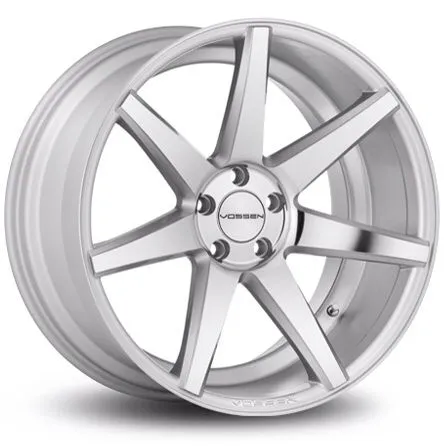

Planning on getting some Vossen CV7s. Just wondering if 20x9 front n 20x10-11 rear can fit. Also wondering if 22s are are go at the same specs. I have a 2014 cx-5 gt. Any help is appreciated! Thank you! image.webp
20-10's should be straight 11's you'd be a test subject I think. If you put 22's your acceleration/mpg will suffer badly. you take a hit with 20's as well. Stock 19" wheel weights ~ 28lb.. good advie is to try to get a wheel of = or lesser weight. your 9 or 10" tire will way 33-38 Lbs.

Planning on getting some Vossen CV7s. Just wondering if 20x9 front n 20x10-11 rear can fit. Also wondering if 22s are are go at the same specs. I have a 2014 cx-5 gt. Any help is appreciated! Thank you!View attachment 207083
@Chris is right :Remind : Those wheels are very weight-loaded ! CV7 is not a forged wheel (although they have the same price of it........Go look for Stance, Niche or TSW.....Cheaper, lighter and much better also !
9 J is vere wide for the front-wheel, it fits, but you`ll have to buy flares, I think........For the rear wheel 11 J definitly you`ll have to get some flares.............
