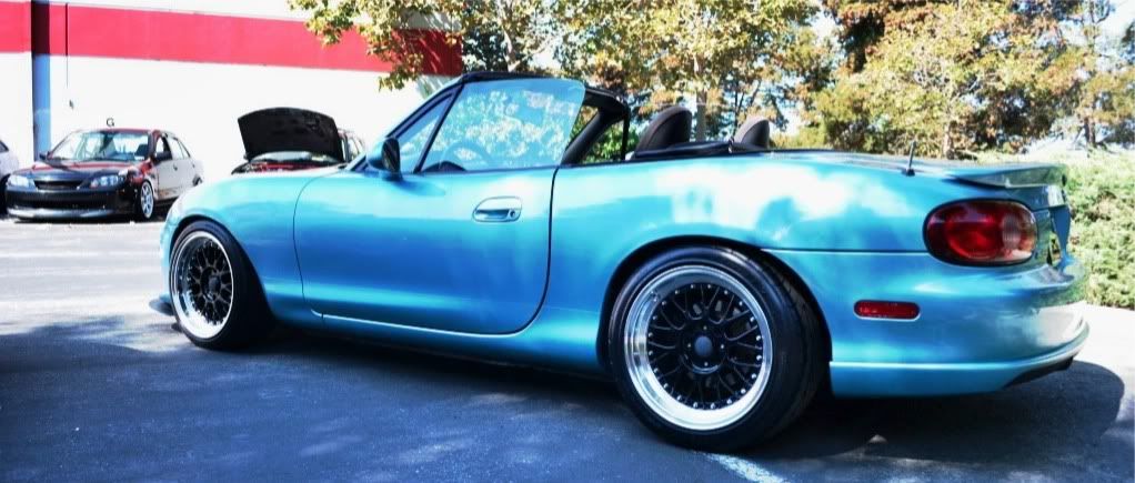

You'll get away with just buying the spoiler and about the mounting points you would need to drill three holes in your trunk lid to mount it.
I have it on my NB2.
