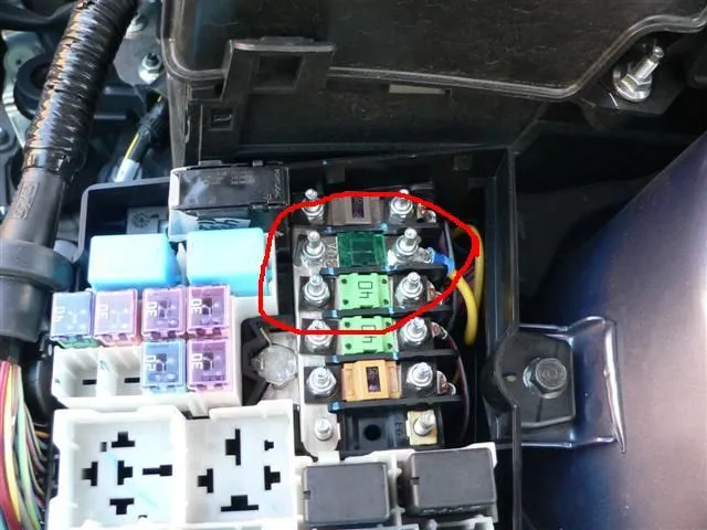

I suggest installing a new fuse in the engine bay fuse box in the position shown in the picture below. You will need a midi size fuse - the smallest I could find was 30 Amps (If someone finds a source for 20 Amp ones please let me know). To install you will need two metric M5 nuts either locking type or with lock washers. If you use the 30 amp fuse, use at least AWG 14 wire.
