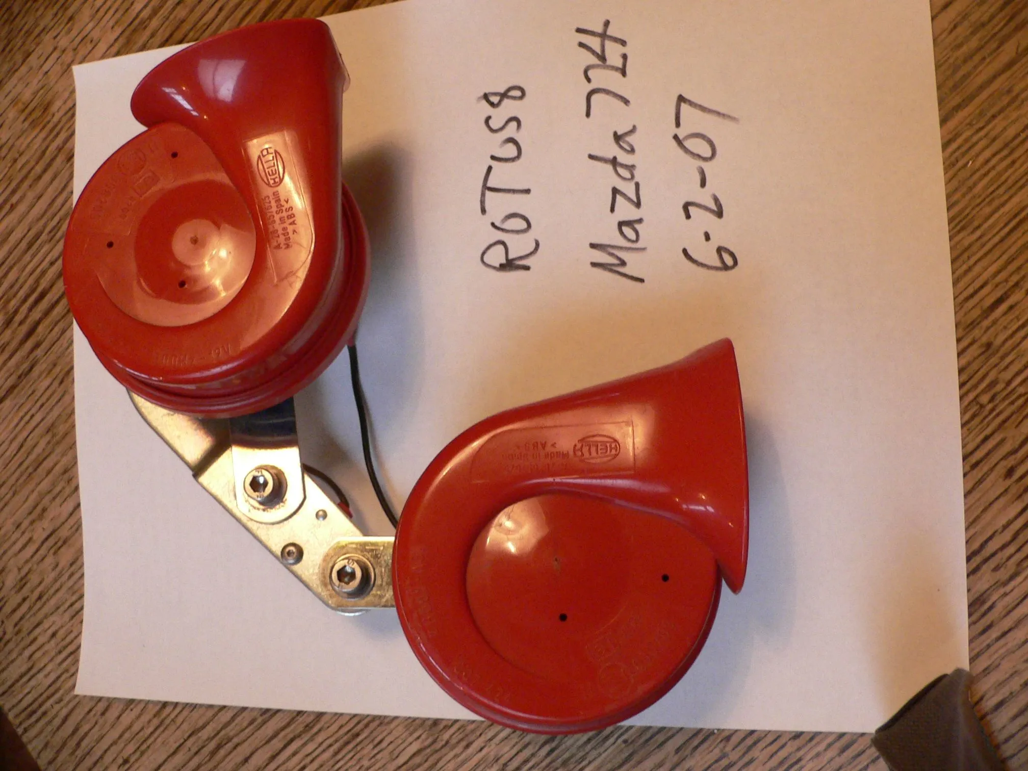

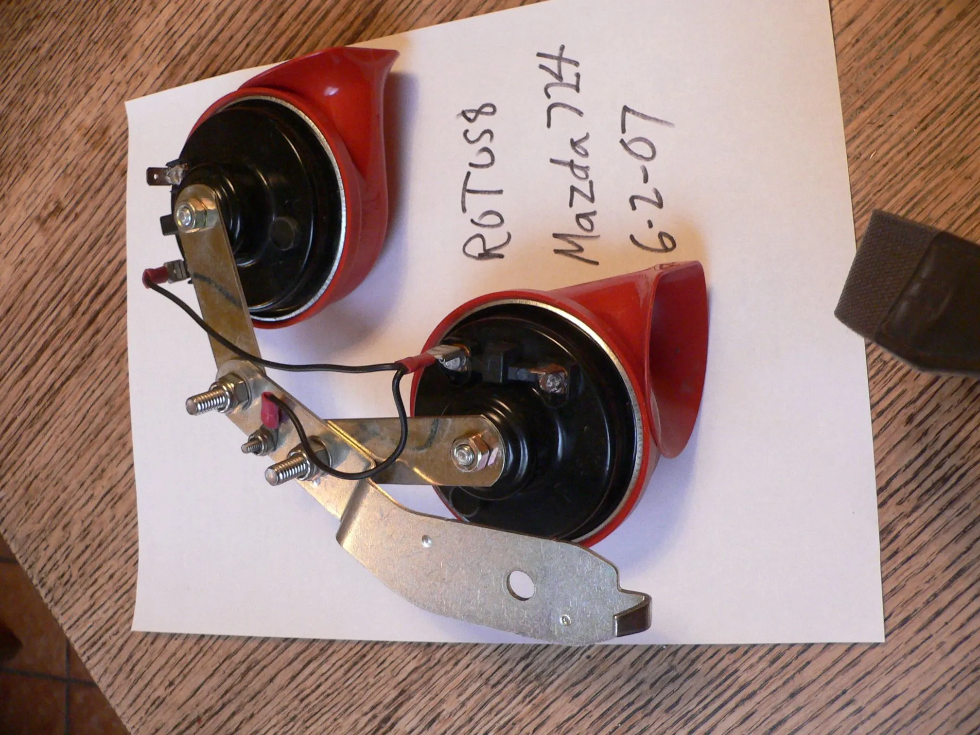

I put in a pair of Hella High/Lows first. They don't require any extra wiring, just hook up to the stock wire. But I prefer the sound of the Nautilus so I went to the next level.
I've got the Hellas in a box somewhere if anyone wants them we could make a deal.
