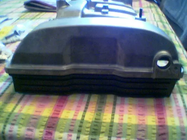

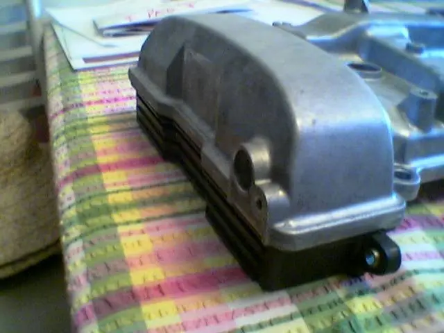

is2 what have you done in terms of being able to get to the adjustable cam gears easily? i was working on my idea last night since the head cover is off the car.
well since it wasn't in a car, there was no need to put the timing belt cover back on...and we simply cut away the pulley side of the head cover all the way around...but leaving the area for the gasket to make a good seal...then just sand it down to get rid of the sharp edges...probably not the best idea for areas with gravel and tons of dust and s***, so my painted cover will go on once in the car...looks better and I don't want a plastic cover on the engine...

pictures of what i've done so far to the head cover
as you can see i have cut the plastic that covers the cam gears basically ni half. the bottom half stays in place with the two bolts down there.
next is to cut the head cover (havent decided which way i'll do this) and glue the top half of the plastic cover to the head cover part that gets cut off. hopefully when it's put back in the car, the two bolts on the top sides of the plastic cover will keep that entire part in place and allow easy and quick access to the cam gears.
what do you think?
