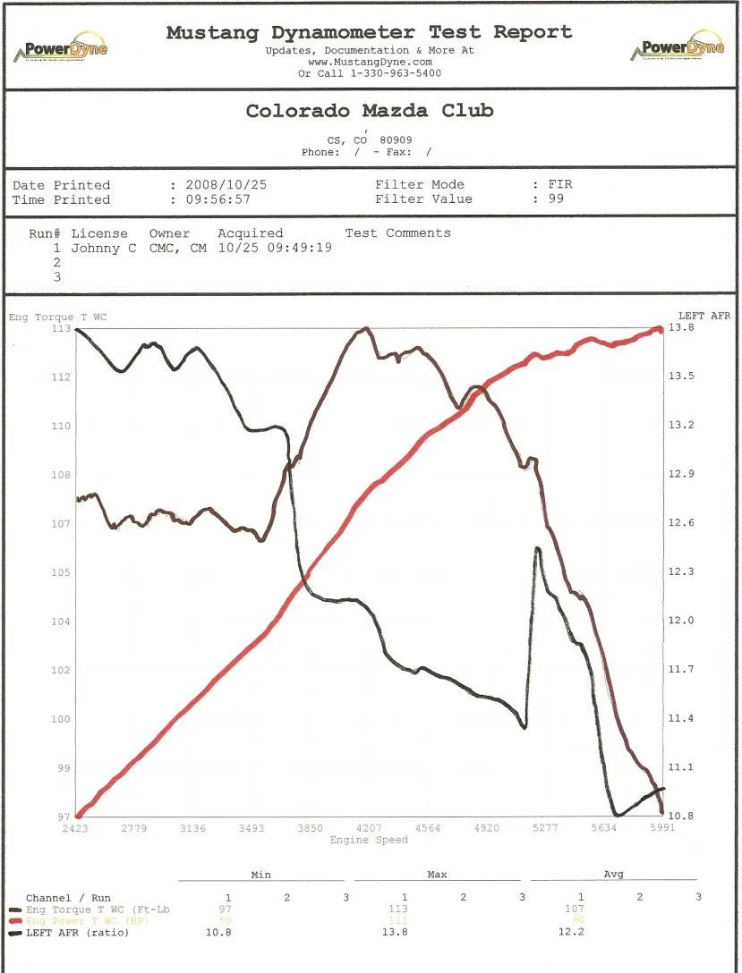

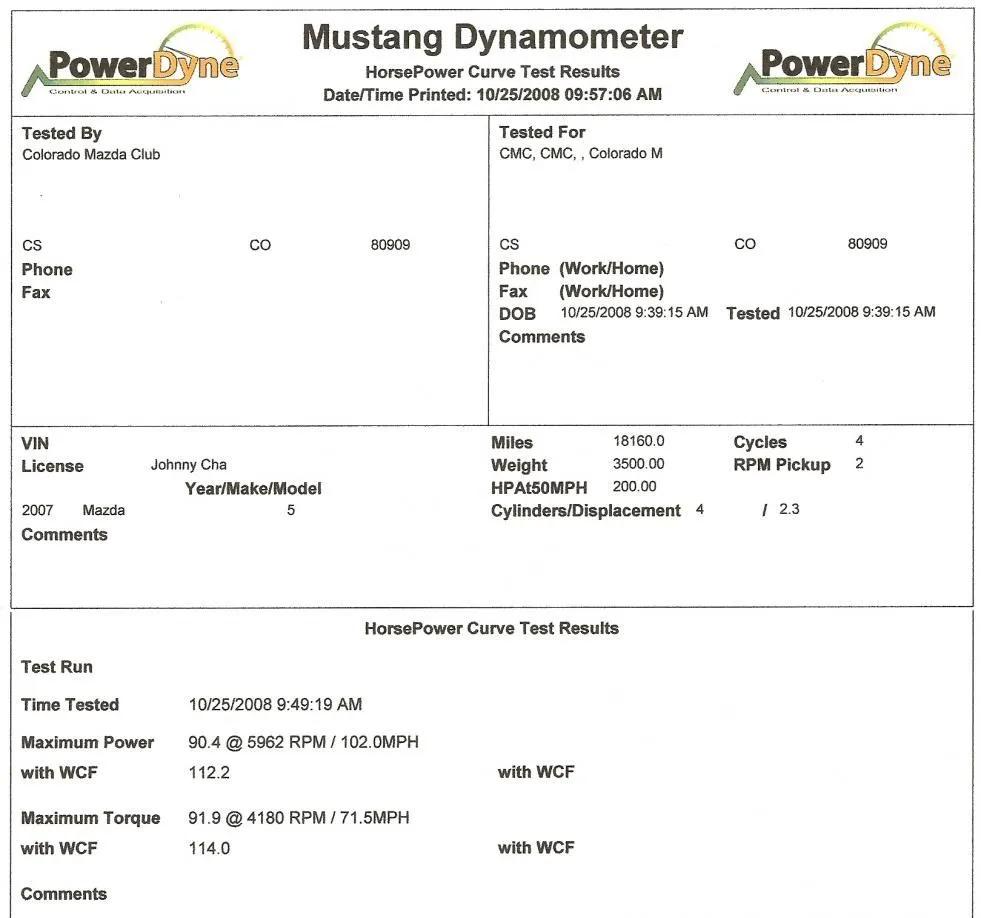

Looks good but too good to be true (I hope I'm wrong). There's an old member who dyno'ed a '07 and had something in the low 100s, which seem about right. The results are the exact opposite in that it show a lot of parasitic loss from the drivetrain. This was done on a mustang dyno in Colorado at the end of October (high elevation+cold temps). The drop iff look alike but this had a more drastic tq drop curve than yous. We need a 3rd opinion for a tie beaker, lol. The Mz3 dynos seem more intune with lower output. I think if this car did output 140 at the wheel, it wouldn't be this slow. I hope I'm wrong.
Edit: The other dyno
Mustangs typically read a good bit lower than Dynojets, but I don't think by THAT much. I typically hear 20-25% under vs the Dynojet. The elevation shouldn't have mattered with the correction factor, but maybe it wasn't set up correctly? I've been using this dyno for literally a decade, and it's always measured right on the money. My S2000 comes out right up against what other people baseline at, actually a bit lower... so I know this dyno reads well.

I don't think Mazda has the engineering chops to pull that off. They (among others) were caught overrating their hp figures in the early 2000s. I recall the NB Miata, RX8, and I think Mazda6 also (can't recall exactly on the 6). Anything is possible with the Mazda3/5 but a 3rd tie breaker would be nice by this is will a hard baseline to go off of since the two we have are polar opposites (type or dyno, location, heat, etc.). Still, good to see some numbers.
At least one of those ratings disputes were from Mazda misquoting the Euro spec (or J-spec, forget which) power figures when the US-spec car was less powerful because of additional emissions equipment- so it wasn't a case of the car not meeting design specifications, more the PR and advertising teams that screwed up.

Hmm. The one in the import tuner article was an automatic. Was the 2007 posted earlier? Maybe the automatic sucks that much more life out of the power going to the ground? Or maybe it has a different ECU program? Time to make some friends over at Mazda engineering...
I don't have any technical numbers to back my statement up, but I used to own a 2006 Mazda5 automatic before I bought my current 2006 Mazda5 manual trans. I can certainly confirm and attest that my current Mazda5 manual is way peppier and quicker then my old automatic one. The auto felt lethargic and I honestly think the auto tranny bogs down the potential of the MZR23.
Good to know. Thanks Davicho! It would be cool if you were able to dyno them back to back, but I know that's not possible now. ;)
happen to come across the post for the 2007 so figure I link it here. It was a 5 speed.
Post #39. Owner also questions the results of the run.
